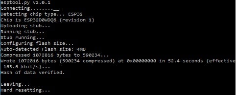

Program with the MicroPython file.
Enter the following command, replacing COMX with your serial port and X:\somewhere\micropython.bin with the location of the downloaded bin file.
esptool.py --chip esp32 --port COMX write_flash -z 0x1000 X:\somewhere\micropython.bin
This will take a few seconds at the end you should get an output as above containing 'Hash of data verified'.

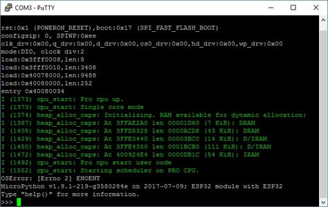

Check Installation using Terminal program.
Open your terminal program, I use PuTTY and connect to the port via a serial connection at 115200 baud. On connecting you should get something like the PuTTY window shown. Do not worry about the error, we shall fix that shortly. In time honoured tradition enter the following line at the prompt.
print("Hello World")
Step 4: Fixing the Error and Uploading the OLED Library.
Fixing the Error
The error comes from missing a main.py file (see here for report). For now we do as suggest in the report and create a main.py that just acknowledges its own existence.
At the prompt enter the following lines.
f = open("main.py", "w")
f.write("print(\"main.py: Hello\")\n")
f.close()
Next time you reboot the board the error will be replaced by the above printed remark.
