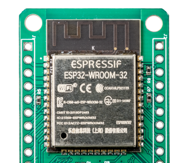

One of the most amazing aspects of the ESP32 microcontroller is its ability to run MicroPython. This can be done in two ways: running full Python programs, or interactively through a console application. This Instructable will demonstrate how to use MicroPython is both ways using the Complex Arts Sensor Board. We’ll first run an example application that gathers accelerometer data from the BNO_085 IMU, then we’ll use a serial program to interactively program in Python.

To get started, we’ll need to download the custom firmware provided by Complex Arts and then flash it to the Sensor Board. The firmware can be found here: https://github.com/ComplexArts/SensorBoardPython/...
Download the firmware.bin file and place it in the folder of your choosing. You’ll also eventually need the Complex Arts example program, so might as well do that now; go to: https://github.com/ComplexArts/SensorBoardPython and git clone or download to the location of your choosing.
