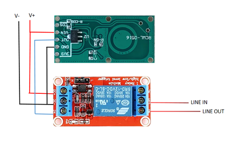

Step 3: Circuit Diagram
Connect vin to dc+
gnd to dc-
out to IN
connect COM and NO of relay module to ac line or other switching circuit
NOTE: Here i used an old 9v battery were the voltage is dropped. Don't use a new 9v battery to this circuit, as it may destroy the relay module. Use a regulated 5v supply.
Never use the RCWL_0516 module with a breadboard , The metal connection pads inside the breadboard will cause interference and reduce the detection range to few centimeters
