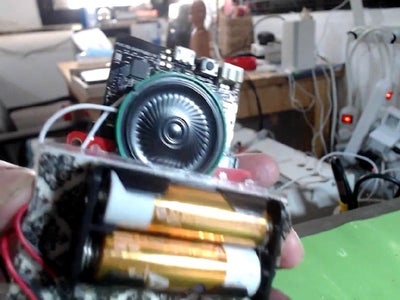

Once you try to actually play it (e.g. powering it via USB cable to a portable charger), the cable makes your movement cumbersome. So I tried to tape it to a LiPo battery. Was fun (because I was cautious enough to stop before the battery discharges completely and dies), but in order to make it kid-safe I'd also need to add a LiPo charger into the thing (at least as a guard against irreversible discharge), and then put all dangling components in a box yada yada.
I've found a breadboard-based solution with:
- 2*AA battery pack
- Sound ✌
- Power switch
- Mute switch
It also leaves enough breadboard space for buttons/leds/joystick/etc. and feels nice and balanced to play with.

- 1 x Micro:Bit board.
- 1 x Micro:Bit breadboard breakout.
- 1 x "half size" self-adhesive breadboard.
- 1 x Micro:bit board.
- 1 x Micro:bit breakout board.
- 2 x SPDT switch (for power and sound).
- 1 x thin 8Ω speaker.
- Breadboard jumpers (or solid-core wires, if you want it to look neater).
- [recommended] 2 x 2-pin screw terminal (for batteries and speaker).
Assembly
See breadboard diagram and photos [including the tooltips] for [hopefully] all you need to know (including what to do if you don't have screw terminals). It takes <5 minutes, and no soldering is required.
