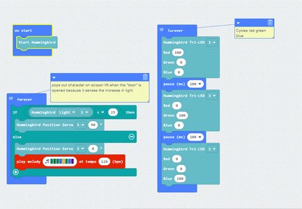

Step 3: Program It
We use microbit makecode to program our hummingbird bit robots. Makecode can be used in blocks or in javascript (and students can switch between)- this makes it very flexible for different experience levels of students. Also, it works on chromebooks, which is what our school uses.
The blocks to run the hummingbird bit servos are found under "extensions".
Students work on programming one piece of hardware at a time (for example: I want this arm to move back and forth between two positions). Gradually they build up a complete solution.
Sometimes students will use the "on button press" event handler as a way to test a chunk of code before making it continuous or tied to a sensor (In the narwhal here, the tail and waves are both currently in testing mode with button A and B on the microbit as the events)
Common errors to watch for:
  • Setting servos or LEDs to the incorrect port (example: plug into port 3 but program port 1)
  • Not turning on the external battery (to power the servos)
  • Misunderstanding about the two servo types (position servos can go to any position 0-180, versus continuous rotation servos which are great for spinning things)
  • Not commenting the code (making it hard to troubleshoot or debug)
