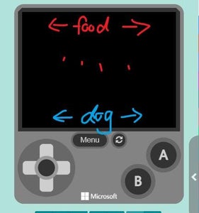

Our idea is to make a game on MakeCode Arcade, and then write another program with MakeCode to control the sprite in the game.
The protagonist - the puppy has to eat the bones dropping from the sky in 25 seconds.
And by tilting Micro:bit to the right or left, the puppy would move correspondingly in Meowbit.
Micro:bit collects its gesture and controls the puppy sprite on Meowbit through the 2.4G wireless communication control.

Step 3: The Program of Meowbit on MakeCode Arcade
Set a radio group 1. When receiving the radio signal from Micro:bit, it controls the sprite (the puppy) to move to the left or right.
Or you can open the program directly on MakeCode Arcade here
When you open the link of this program directly, you may find that the box of the Set Radio Group is blank, then please delete the block, and then drag a new one from the Sdwireless section and change the number 0 into 1.
When you finish your program, download it to your Meowbit.
Step 4: What Should I Do With the Error Report
If you see an error report when opening the MakeCode Arcade program and the simulator is not working, it is because MakeCode Arcade currently doesn't support the SD wireless BLE module perfectly. We can just ignore it, because it works at last when downloaded to the game console (Meowbit).
