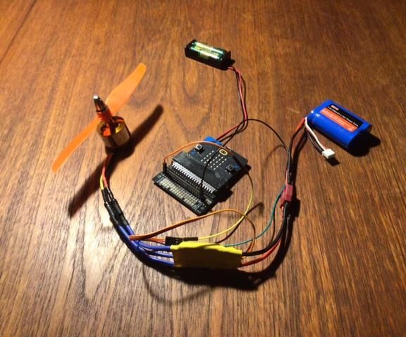

Now mount the air:bit onto the drone frame.
Put wire up the motors to the air:bit as shown on the picture.
Mount the battery onto the drone with the rubberband.
The drone is now finished.

First turn on the controller and the drone. The drone should be on a stabel horizontal surface.
Press a+b to arm the drone. The propellers should start spinning. A and B controlles power.You often need to increase power many times before the drone will start lifting.
The most common problem if the drone doesn't work is that either the braze tube or the nuts isn't tight enough.
