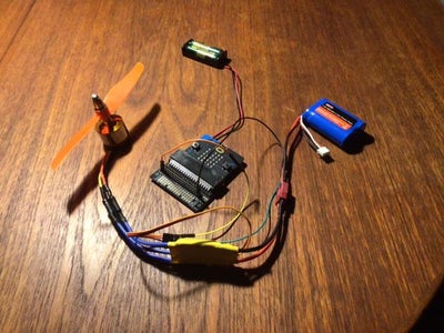

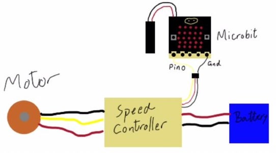

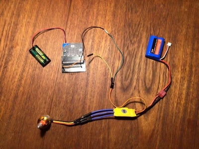

Step 1: Wiring

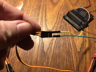

Wire up the circuit as seen on the drawing and picture above. Most of it is pretty straight forward, since the different connectors helps with showing what should be connected with each other.
The importent part is that you should not pull power from the speed controller to the micro:bit, since the speed controller supplies 5 volt and the micro:bit can only take 3.3 volt. So only connect the signal and ground.
The 5 volt from the power supply can be pretty handy. If you want to build something that also needs servo motors, such as an airplane for example, then the speed controller can supply 5 volt for the servo motors that controls the wings.

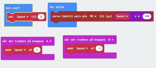

Step 3: Coding
First you go to the Makecode editor and start a new project. Be aware that since I am danish, these buttons have slightly different names in the pictures.
On start the program set the variable Speed to 0. The A and B buttons just add or remove 2 from the Speed variable.
Since the speed controller uses the same 50Hz PWM signal that servo motors also uses, we can use the servo set pulse block to control it. The puls is ontrolled in microseconds. A microsecond is 1/1000 of a millisecond, so we multiply the speed variable with 100.
Here is the program.
This is a rather safe program where ou have to push the A button a few times before the motor arms itself. You can try to set the starting value of speed to something like 7, so you don't have to push A that many times to arm the motor. You can also change the value that the A and B buttons to change how precise you can control the speed.
