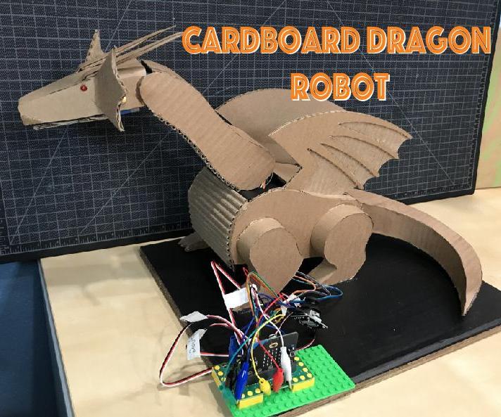

The MakeyBit cannot move by itself and you may have noticed that its arms are solidly by its side. But there are other ways to add movement to the scenes. One of the easiest ways is to prop the MakeyBit so it can be moved by the motor, but the MakeyBit can be heavy once you insert the batteries and the little servos are not very strong.
Another way to add movement is to have different characters or props be the ones moving. You can create additional characters with the same MakeyBit skin templates and mount those on cardboard. They will match the style of the MakeyBit, but you can then mount them onto the servos and have bigger movements. You can also cut their arms and mount motors behind the character and glue/tape the arms to the servo horns so they can move.
Props can move in different ways, but take into account weight. The little servos can’t handle too much weight.

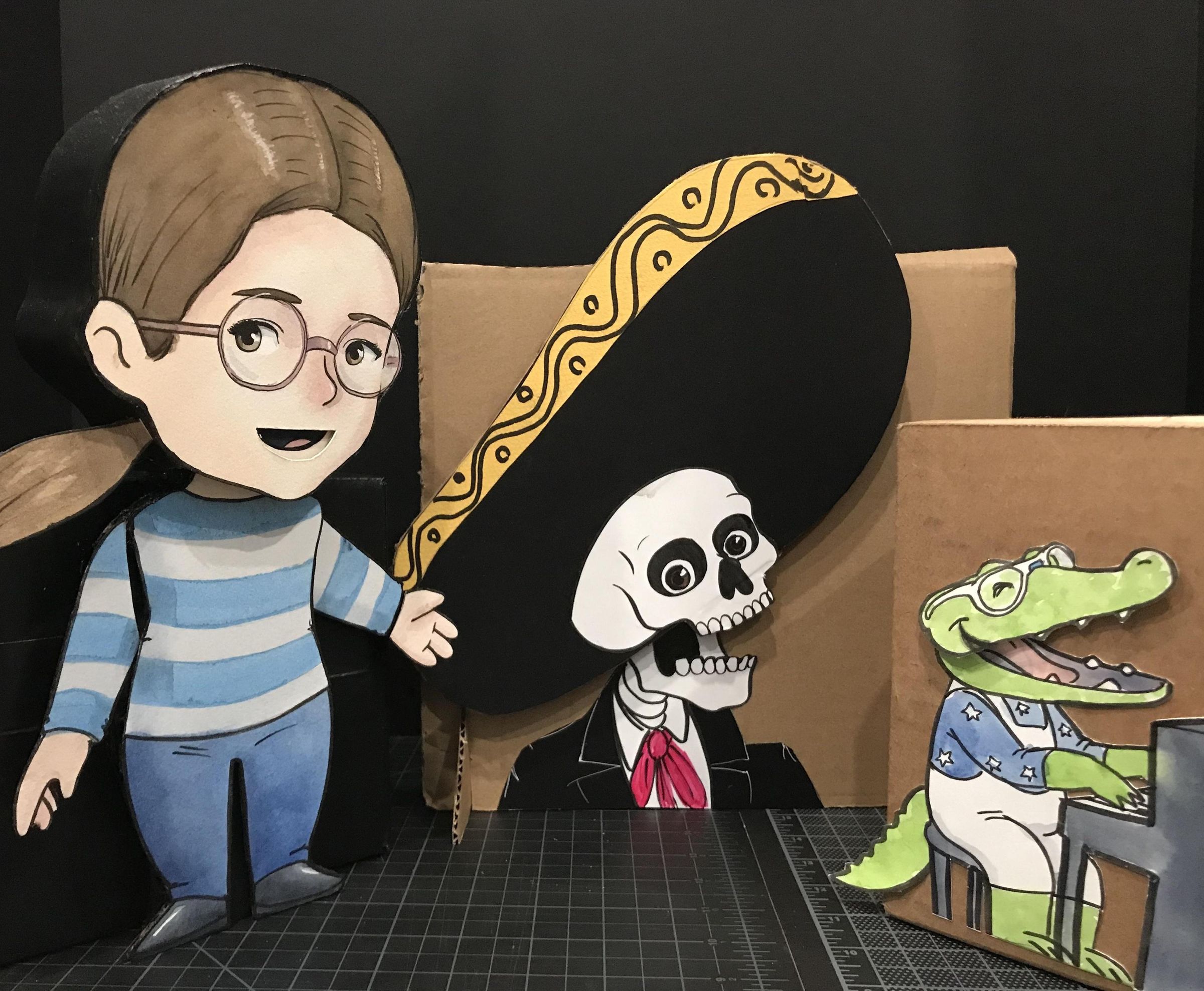

To design the characters, you need the MakeyBit blank template. You can draw on top of it or trace the template into a new piece of paper. The template should be printed or traced on thicker paper and without scaling it.
For best results, find a good photo of your character or take notes of their description, if no photos are available. Do your best with the likeness. It's a MakeyBit. It's silly. The likeness will never be perfect.
As mentioned before, the MakeyBit itself cannot move. Its arms are stuck on its side. But that doesn’t mean you can’t add movement to the characters. If you have more than one character, you can have one controlling everything and the other can be moving around. Or even move the whole Makeybit with the motors, but that has to be done with care as it is heavy once you add the batteries.
For my Jane Goodall project, I designed her outfit based on research I made, and then I made the extra characters (chimpanzees) using the same template, except the eyes in my case were planned to have LEDs. You can have the eyes just painted on. Since I wanted David Greybeard to fish for termites, I knew I wanted his arm to move. I used brads to connect pieces of his arm to his body. The movement comes from the end of the stick he uses. That is what is connected to the motor. The motors in the scene are connected to Jane Goodall but the cords are hidden with the background elements.
In this student project, inspired by a scene from Ironman 2, you can see Ironman is the MakeyBit that holds the Micro:bit. Whiplash was created using the MakeyBit template and glued onto cardboard, but his arms were cut and mounted onto servos that are glued to his back. The servos are controlled by the Ironman MakeyBit.
The last video is another student project, based on Harry Potter, where the student chose not to have the MakeyBit in the scene. He wanted to be able to control the feather from the back, and that is also ok. He used the same template to design Harry.
