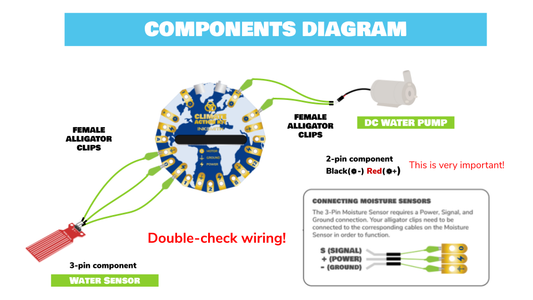

Step 1: Set Up the Pump & Moisture Sensor

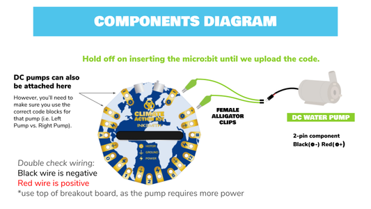

The DC Water Pump should be attached to one of the two sets of positive (+) & negative (-) connectors at the top of the breakout board. Remember which set you connect your pump to, as you'll need to add that to your code later! Details on connect the pump will be in the final step.
The red wire on the pump is positive, and black is negative.
The Water (moisture) Sensor has three connections.
  • The + (power) will connect to any of the power (lightning bolt) connectors on the breakout board.
  • The - (ground) connects to any of the ground symbol connectors on the breakout board.
  • The S (signal) will connect to 0.
    Remember which pin you attach the sensor to so you can add that to the code later!
You can find more detailed set-up instructions supplied in your kit.

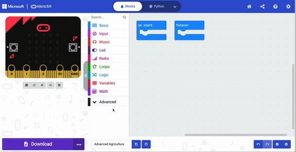

Step 2: Start a New Project in MakeCode & Install the Climate Action Kit Block "Drawers"

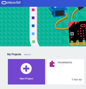

To begin coding open up MakeCode on a computer or tablet, click "New Project" then give it a name! When you're ready, click "Create".
For this project, we'll need to install some custom code blocks (see gif above). To this you'll need to:
  • Click "Advanced" in the block menu.
  • Scroll down and click "Extensions" at the bottom.
  • Search for "Climate Action Kit" and "climate-action-kit" should be the only result.
  • Click climate-action-kit to install, or "Learn More" if you want to learn more about the extension.
Now that the Climate Action Kit extension is installed, you should see several extra menu items to select including: servos, soil, motor, pump, and touch.

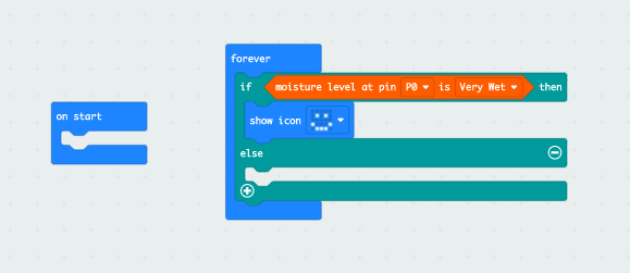

Step 3: Write the Code for the Water Sensor
The first part of the code instructs the system not to activate if the moisture sensor is wet.
We'll need to start by looking in the logic section for an "if" statement. An if statement will only perform an action "if" the code sees the thing we tell it to look for. We're going to us the "if/else" block, so that we can give a further instruction when the thing we tell the statement to look for isn't happening.
Block code needs to know when to do the action your telling it to do. So if you just drag the "if/else" statement somewhere in the code area, it will grey out. The action can take place:
  • On Start - Just once when you start the microbit.
  • Forever - Constantly as long as the Microbit is running.
  • On Action - when something happens (button pushed, micro:bit tilted, temperature changes, volume increases, etc)
We'll use the forever loop, as we want the micro:bit to always pay attention to the plant and supply it with water when needed.
Finally we need to tell the if statement what it needs to look for. Click into the "Soil" menu, and you'll see 3 different options with different sides (rounded, pointed, and flat). If you look at the if statement, you'll notice that "True" is in a shape that has the pointed sides. Grab the matching shape variable and drag it over the "true" in the if statement.
Set your pin according to where you connected your moisture sensor, and the moisture level to wet or very wet, depending on your plants preference.
Now we need to tell the if statement what to do when the plant is full of water. Go to the "Basic" menu, and drag either the "show leds" or "show icon" under the if command. Draw an image, or set the icon to whatever you would like to show when the plant is watered.

Set left/right accordingly to where you connected your pump to the breakout board.
