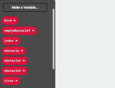

Step 1: Declaring the Variables
Before we get started, we will declare some variables. These variables will be used to store information to be referenced and manipulated when we program this game and thus allow us to code more easily.
For creating variables search for Variables under the Blocks Toolbox and then click on Make A Variable. Write the name of the variable in the New Variable Name dialogue box that pops up and clicks OK.
We need to create 7 Variables for our game:
  1. Bird
  2. EmptyObatacleY
  3. Index
  4. Obstacle
  5. Obstacle2
  6. Obstacle3
  7. Ticks
