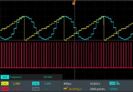

The Analog signals will be sine and sawtooth waveforms.
But how will the conversion for each of these waveforms be accomplished.
Step 2: Digital Sawtooth
A digital sawtooth waveform can be generated using a binary counter with weighted outputs.
Using a 4 bit binary counter we can generate 16 discrete steps
With a resistor R on Q0 a current flows when Q0 is high.
If we place a resistor on Q1 that's R/2 then twice the current will flow when Q1 is high.
Consequently, if we fit resistors of R/4 on Q2 and R/8 on Q3 then we have a binary weighted current for each binary step.
The resistor values following an ideal weighting would be 120k, 60k*, 30k & 15k.
*No preferred resistor value exists for 60k as a single value the closest is 59.7K (E96/E192 series), however it can be made simply with two 30K in series.
If the summing point is connected to a load resistor each current step generates a corresponding voltage step.
The frequency of the output waveform = Fin/2^n where n = weighted outputs.
Therefore if Fin = 1KHz then the sawtooth frequency will be 1000/16 = 62.5Hz
Step 3: Digital Sinewave
A digital sinewave waveform can be generated using shift resisters with weighted outputs.
Using two 4 bit shift registers we can generate 8 discrete up steps and 8 discrete down steps for symmetry.
For the first shift register.
With a resistor R on Q0 a current flows when QO is high. If we place a resistor on Q1 that's R./2 then twice the current will flow when Q1 is high. Consequently, if we fit resistors of R/4 on Q2 and R/8 on Q3 then we have a weighted current for each step counting up.
For the second shift register.
With a resistor R on Q3 a current flows when Q3 is high. If we place a resistor on Q2 that's R./2 then twice the current will flow when Q2 is high. Consequently, if we fit resistors of R/4 on Q1 and R/8 on Q0 then we have a weighted current for each step that reduces as the count increases.
If the summing point for both counters is connected to a load resistor each current step generates a corresponding voltage step.
The frequency of the output waveform = Fin/2^(n/2) where n = weighted outputs.
Therefore if Fin = 1KHz then the sinewave frequency will be 1000/16 = ~62.5Hz

The voltage at the summing point is fed to the non inverting input of one half of a dual Op-Amp configured as a non inverting amplifier.
A 5k (Rf) potentiometer is connected in the feedback path in conjunction with a 220R (Rp) to control the waveform output amplitude. Vgain = 1+Rf/Rp with Vgain from 1 to 24 enabling the output voltage to be controlled from ~0 to 3V.
The Shift Register transfers data on each positive transition of the clock and the last stage (Q3) of register 1 is connected to the data input of register 2 with its last stage (Q3) fed back to the data input of register 1.
At switch on all the registers are reset to zero but the inverter connected to the data input of register 1 sets each stage to a logic 1 on each clock transition. Giving a progressive increase in voltage.
Once the last stage of register 2 is set to 1 the data input is set to 0 by the inverter and each stage is successively set to 0. Giving a progressive reduction in voltage.
The result is a repetitive digital sine wave.

Power the Function Generator from a suitable power source via USB, the connector opening is on the right hand side.
It will initialize and display the status.
This will be Output disabled, Max frequency range: 1000Hz, Frequency 0Hz.
There will also be a green glow from the power indicator visible around the display.
Press the Enable button to turn on the outputs and the pulse frequency will be displayed.
Press the Range button to change the maximum frequency range.
Turn the frequency knob to adjust the frequency value.
Adjustment of the frequency will effect the sine, sawtooth and pulse waveforms.
However, sine & sawtooth will have a frequency 16 times lower than that at the pulsed output due to the D2A conversion process.
The sine and sawtooth waves have independent amplitude control from ~100mV to 3V.
The pulse output voltage is fixed at 3V maximum.
However, a potential divider on the output will allow setting of different voltages using the formula.
Vout = 3V*Rout/Rtotal where Rtotal = Rin+ Rout in series from the output to 0V, with the output taken from the centre tap of the two resistors.
If Rin =10K and Rout = 5K then 3V*5K/15K = 1V maximum.
