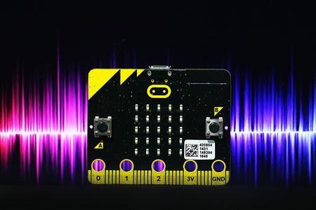

A piece of music usually consists of tones and rhythms. Different tones correspond to different frequencies. And rhythm controls the holding time of a tone. If we change rhythm, the tone will change with it. If we combine tones and rhythms according to a certain rule, then we can create a harmonious melody. If we relate the combination of tones and rhythms to the wavy frequency output by micro:bit analog footers and its lasting time, and input these signals into a loudspeaker, then it can broadcast the melody. And BBC Micro:bit has very powerful music functions. With this conception, we can use Micro:bit to design our own music broadcaster. Today we are going to use micro:bit to make a music broadcaster.
