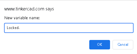

First, make a new variable called Locked, which we will use later to tell the microbit if the key is inserted and is in security mode(You can pass through the lasers without activating the alarm) or in protection mode(The piezo buzzer starts to beep when you brake the laser light passing).

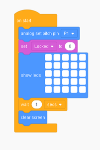

Step 3: Coding the Start
Now, when we start our code, we set the analog pitch to pin 1 where we connected our piezo buzzer which can be used to make a beep sound and alert us. Then, we set the variable Locked to 0 (Indicating that it is in security mode and not protection mode) the show leds in the next line isn't nessasary, you can either avoid that step or make a boot up image type. And then we wait for a second and clear the display. But make sure you don't avoid the first two codes (set anolog pitch to pin 1 and the set Locked to 0)

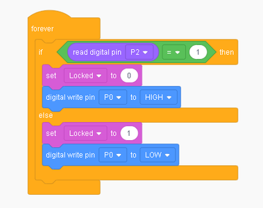

Step 4: Security Mode and Protection Mode
Now, we will define our variables inside a forever loop. We add an if else block and inside 'if', we check the input from pin 2. If the reading is 1, meaning that the switch or the sensor is on, we set the Locked variable into protection mode(You can not pass through the lasers) And set digital pin 0 (The laser) to high, meaning it will glow brightly. And inside else block(if the user inserted the key) we set the laser to off and we set Locked to 1.

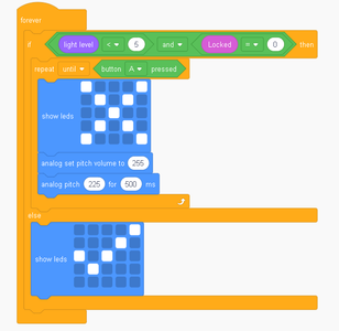

Step 5: The Main
Now, we will make the main code in side a forever loop. We add an if else block. inside the if block, We use the inbuilt light sensor on microbit(The 25LEDs itself are the used as the light sensors) to see if the light is below 5 and locked is set to 0. And if its true, the microbit will display a cross sign and start beeping(using piezo) until you press a. If the light is braked, you will have to insert the key and then press a to stop the beep sound. The reason we added the until block is that we do not want to stop the alarm after the light is broken. In the else block, when the light level is above 5, or the light level is below 5 and the Locked is 1(security mode) the microbit shows a tick sign.
