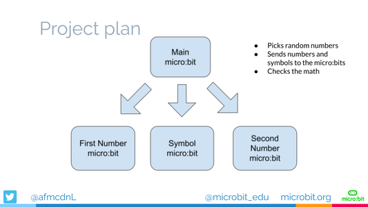

With the plan in mind - there is one primary micro:bit and three secondary micro:bits. The primary micro:bit does all of the control, sending of the numbers and math. The three secondary micro:bits are only for the display of two numbers and the math symbol.
