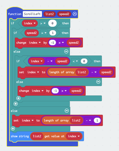

Step 3: ScrollLeft and ScrollRight
Create two functions; ScrollRight and ScrollLeft. Give both of them two parameters, an array and a number.
We want to make it so that by holding either button, we can fast-forward through the letters at a specified speed. However, we can't just have the index simply increase by the speed, because that would produce an error when the index is greater than the length of the array. We also want the screen to loop back around to A if we scroll past Z and vice versa.
In the two functions you just made, add the code above.

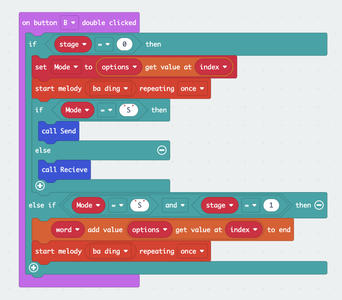

Step 5: Main Menu Double-Clicked Button Actions
Add the following code to run when button B is double-clicked. If the stage is 0, the mode will be set at the current indexed value of the options array. It will also play a sound effect, because why not. If the mode is set to "S", then the Send function will be called, which we will add in the next step. If the mode is set to "R", the Receive function will be called, which will also be added in the next step.

Step 8: Selecting a Letter
To your "on Button B double clicked" event, add an "else if" statement by clicking on the plus sign on the bottom of the if statement. Then, have the else-if statement check whether the stage is 1 and the mode is "S". If so, then it will add the current letter to the end of the word array that you created in Step 2. You can also add a sound effect to confirm that it your letter was added.

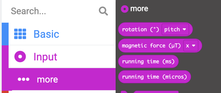

Create a new variable called timer, and have both functions set it equal to the current running time of the program in milliseconds, found in input => more. We will use this to determine how long the spaces between clicks are.
The dot function will play a 1/2 beat to indicate that a dot was added, while the dash function will play 1 beat to indicate that a dash was added.
