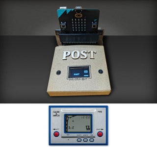

Introduction: Micro:bit OLED Game
There was a time when every kid wanted a Nintendo Game & Watch handheld electronic game. This combined a very simple LCD screen with a very simple game mechanic. An early example was the Fire game, where you moved the firemen’s safety net left or right to bounce residents from a burning building on the left into a waiting ambulance on the right.
Let's add an OLED screen to the BBC Micro:bit to create an homage to these games. We'll need to use a breakout board and a breadboard to connect the Micro:bit to a 128x64 OLED display, and we'll need to write the game in Python. We’ll call the game Post, and bounce letters from left to right using a paddle.
Because we're using an OLED screen, we'll need to create the real thing rather than use Tinkercad. We'll need at least the following:

Step 11: Optionally, Use a Printed Circuit Board
A breadboard makes it very easy for us to plan and test a circuit, yet is not ideal for a finished product which should last a while. To produce a smaller form factor with more permanence, we can recreate our circuit on a printed circuit board (PCB) breadboard.
This requires soldering the components and wires onto the board. The image above shows my original breadboard version on the left, and my recreated PCB version on the right. You may not be surprised to learn that this was my first ever attempt to use a PCB, and my first ever attempt to solder components and wires. So please accept the above image as merely an example, and certainly not a template to follow.
While we could produce a smaller circuit, the size of the Micro:bit and its breakout board means our final size will never be tiny. We also can’t aim for a too-small form factor if we want to place buttons on either side of the OLED display.
Step 12: Optionally, Create a Casing
Whenever we create an electronic device, we can choose to leave it in its “raw” form with exposed components and wires. Or, we can choose to create a final “product” where we endeavor to expose only those components needed by the user—in a handheld game, that’s typically the screens and the buttons.
The above image shows a basic effort to create a cardboard product case. While we could extend the cardboard case to hide the Micro:bit except for its LED, doing so would make it difficult to update the game, or indeed to extract the Micro:bit for use in another project. So we can choose to hide the PCB and wiring, yet show the Micro:bit.
