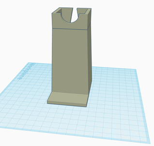

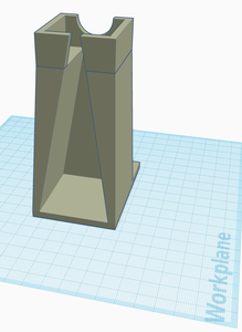

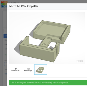

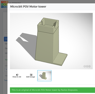

  • Two 3D printed components, one being the "tower" that houses the stepper motor and the other being the "propeller" that houses the rotating micro:bit. You can of course use your preferred construction method instead of a 3D printer - glued Lego bricks would be a nice alternative. I have attached the STL files for the 3D printed parts but you can also access them directly in Tinkercad here and here.

When you are done with the tower electronics, you can place the motor on top of the 3D printed tower and maybe hide the board and the cables in the back of the tower. The tower is designed to be a snug fit for the motor, provided that your 3D printer prints within reasonable tolerances. You can however glue or tape the motor on the tower for this extra bit of secure feeling. What's more important is to fix the whole tower assembly on a surface - I used a double-sided tape to fix it on my table.

Things are pretty simple for the propeller part: Connect the second ("flyer") micro:bit to the battery pack provided with the micro:bit Go Starter Kit. The two AA batteries are conveniently included in the kit. Attach micro:bit + battery pack to the 3D-printed case and fix it with some double-sided tape. You may want to postpone this part until after you have programmed the micro:bit and you are ready for the first tests.
