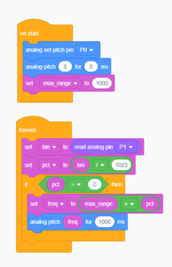

Basic code to illustrate the method and circuit layout created in TinkerCad.
Used the analog pitch function as ring tone is not available but it illustrates the method.
In practice analog pitch has stability issues and instead ring tone is used in the final application.

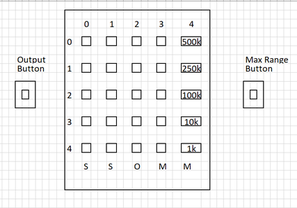

This implementation will primarily make use a potentiometer to allow continuous adjustment of output frequency. With the two buttons to control frequency ranges and enable the output.
Button A will be used to enable and disable the output.
The centre LED indicates the output status, LED on, output enabled, LED off, output disabled.
Button B will be used to define the max range 1kHz, 10kHz, 100kHz*, 250kHz, 500kHz^
*Microbit V1
^For Microbit V2 (& Selections >500kHz on uBit V2 defaults to 1MHz)
The last column displays the maximum range selected by Button B

On start
This calls reset (variables assigned and initial values set).
If using Microbit V2 which has a built in sounder this will need to be switched off, ignored if using V1.
Button A - Output Enable
Switches the centre LED on for output enabled or LED off for output disabled
Default on start up is output disabled.

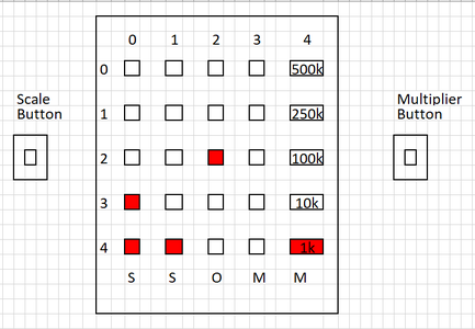

Button B - Range
Illuminates one of 5 LED's in column 4, on each button press, starting from the bottom to the top.
Sets the max_range on each button press for 1k, 10k, 100k, 250k & 500kHz
max_range on start up is 1kHz
Pot_Adjust
Reads the analog input on P1
Converts it into a percentage of the maximum bit count and into a frequency based on the maximum range.
Frequency = max_Range * (bit value/1023)
Update the display value relative to the selected max_range
Forever
Where the ring tone is applied with the required frequency.
Output enable is applied here subject to its status to output the required frequency or zero frequency.

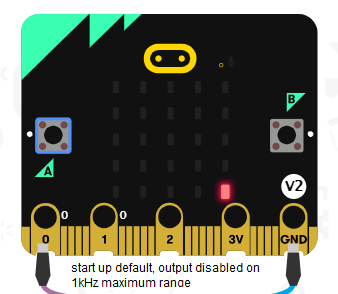

The Microbit will display the title V_PGEN (Variable Pulse Generator), then illuminate LED at co-ordinates 4,4.

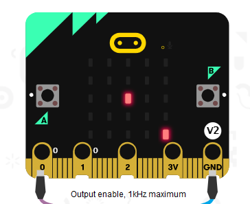

The output at P0 is disabled by default and is toggled between enabled and disabled by pressing button A.
The centre LED at co-ordinates 2,2 will illuminate if the output is enabled and off if disabled.
Default maximum range is 1kHz

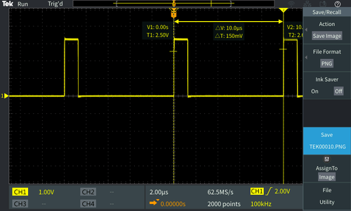

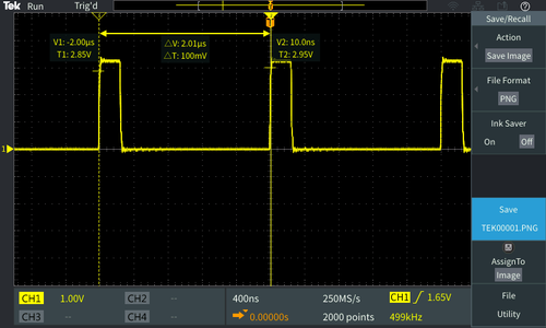

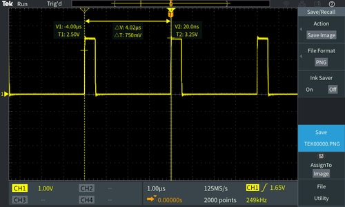

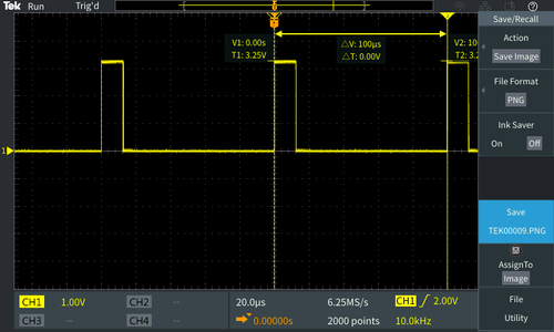

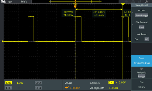

You can monitor the output at P0 in a number of different ways some with more limitations than others, Oscilloscope, frequency counter, LED or meter.
Waveforms are shown for 1kHz, 10kHz, 100kHz, 250kHz & 500kHz verified on the oscilloscope with time period.
Frequency = 1/Period
Nominal positive duty cycle 12%.
The output voltage is 0 to~3V, interfacing to other Microbits or logic as the same supply voltage should have few issues.
