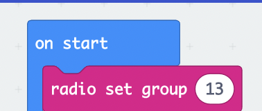

Create a new file in the MakeCode editor. Time to start writing the code that runs the remote controller Micro:bit. Add a 'radio set group' block to the 'on start' block. In order to communicate with each other wirelessly, all the Micro:bits need to be set to the same group number. You can use any number between 1 and 255 as your radio group number. A student who was working on a related micro:bit radio project noted that this step was like making sure all the walkie-talkies are on the same channel.

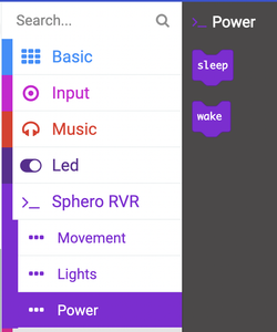

Step 9: Your New Sphero RVR Extensions - Sleep/Wake
These extensions allow you to control the sleep/wake state of the RVR through code.
Step 10: Set Radio Group
The code for the RVR's 'brain' will turn signals into actions. In order for the two Micro:bits to communicate with each other they need to be in the same radio group. Add this block to the on start block of your RVR driver code.
