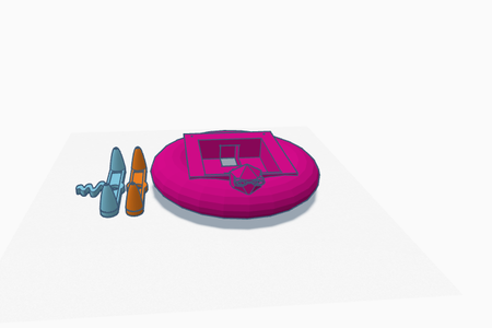

Step 1: Print the Parts
We used regular FDM printer to print the parts, with the following settings:
Nozzle diameter 0.04 mm
Layer height 0.2 mm
13 % infill
Raft+supports
As you can see, with layer height 0.2 mm the glasses on the model are not printer properly, so if you'd like you can decrease layer height to 0.1 mm - that will slow the printing speed, but allow for finer details to be printed.
