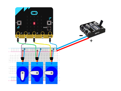

The connection of the wires is very simple, it is even shown by the micro: bit editor (or see the image).
Better to use a supplementary battery to give more energy to the SG90

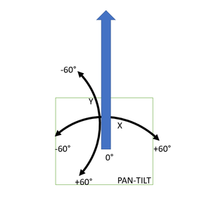

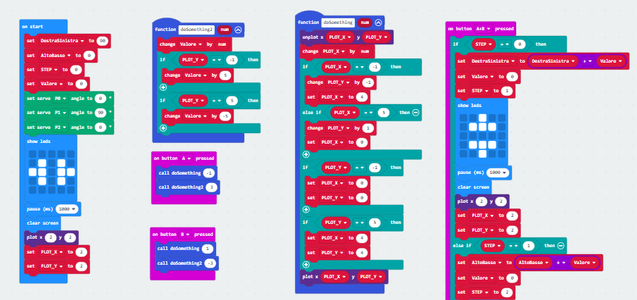

the software has to enter the coordinates for the elevation angle and the direction on the X axis.
the total movement is 120 ° , 5 ° for each step.
Step 4:
the source is at the following link :
https://makecode.microbit.org/_dxPPFAAFLTc6
