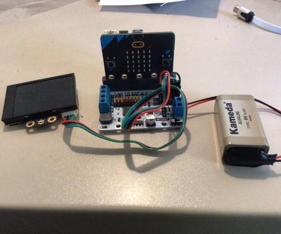

Step 7: Connect the Wires
Strip the end of the wires and connect them to the motor:bit. Screw the two wires from the right motor into M1 + and M1 - and the two wires from the left motor into M1 + and M1 -. I place the red into + and the green wire into -.
Step 8: Connect the Battery
Screw the battery holder into the motor:bit. Black wire to GND and red wire to VIN. Then take your small piece of double sided tape and place it at the rear of the smar car and put the battery on top of it.
The smart car is now finished and ready for you to add your micro:bit.
