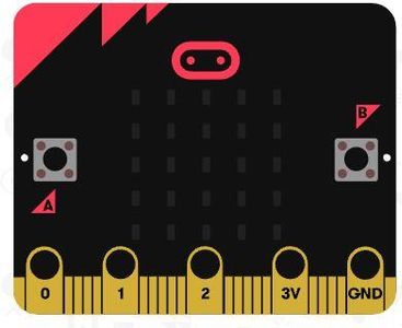

1x BBC micro:bit

Step 2: Test Program
Use the emulator to test the program. if it doesn't work you can change the code

Simply download the program from the bebsite and then upload it into the micro:bit
Step 4: Use It
have fune with your new stopwatch and try to time your 100m sprint
