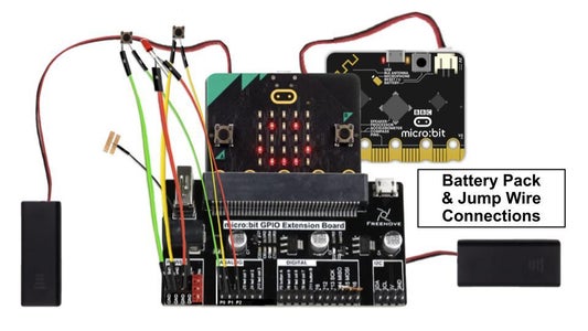

Step 4: Visual Diagram
Use the Diagram to assist you in connecting your micro:bits to your Virtual Cat (*see equipment list)
Step 5: Instructions
Instructions:
Use the back micro:bit to connect all jump wires used, and use the back micro:bit as the controller for the front micro:bit’s LED Screen, Sound (including the external clap), External Ear Buttons, & External Red Led Light Tongue.
Using the back micro:bit
Press Button A to display Zzzz... with sound on the micro:bit LED display
Press Button B to display Hello with sound on the micro:bit LED display
Press Logo to display HaHa with sound on the micro:bit LED display
On Virtual Cat
Press Right Ear Button to display Hug with sound on the micro:bit LED display
Press Left Ear Button to display Kiss with sound on the micro:bit LED display
External Sound
Clap Your Hands to display a heart-like shape on the micro:bit LED display
