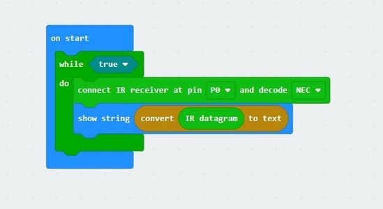

Click the MakerBit button above the advanced button and drag the “connect IR receiver to pin…” block inside the while loop.
We will then change the decode mode from “Keyestudio” to “NEC”. (NEC is a transmission protocol for Infrared devices to communicate with the receiver).
Drag the “show string” block from the Basic tab and put it under the “connect IR receiver to pin…” block.
Then drag the “convert” block from the Text tab underthe advanced tab into the “show string” block.
Next, drag the “IR datagram” from the MakerBit tab into the convert block.
This code on start searches pin 0 for an IR input using the NEC protocol. It then shows the input it receives as an IR datagram. The while loop repeats this program until we turn off the Microbit.
The Final code is shown above.
