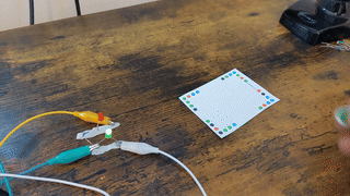

Step 6: LED (Pin Control) Via BLE UART Example
This example lets you use paper dot markers to turn on and off LEDs by sending messages over BLE UART!
Circuit Design:
  1. Connect one wire (yellow in picture) from the "0" Pin breakout on the micro:bit to the positive (+, longer) lead of an LED (pictured in red). A 220 ohm resistor was used in this example to set lower LED brightness, but may not be necessary depending on your chosen LED. (grey sticky-tack used to hold components in position)
  2. Connect one wire (pictured in white) from the "1" Pin breakout on the micro:bit to the positive (+, longer) lead of a second LED (green in picture).
  3. Connect the negative (-, shorter) leads of both LEDs to a wire (green in picture) that is connected to the ground (GRD) breakout on the micro:bit.
Paper Design:
This example uses one paper program (default: #7) that sends a UART message depending on the color of the paper dot marker placed on the program. A RED dot marker sends a UART message to set pin 0 to UP (1). Removing it sets pin 0 to DOWN (0). A GREEN dot marker sends a UART message to set pin 1 to UP (1). Removing it sets pin 1 to DOWN (0). A string of Text updates on the Display that echoes what the micro:bit received over UART TX.
