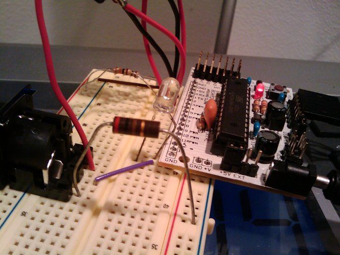

Put your parts together as shown. Be sure to use rubbing alcohol and a flux brush when you are done to get rid of any flux from soldering.
Schematic is below for those who prefer it. D1 and R1 can be whatever you want, it's just a power light. C1 is just to help make the power a little more consistent. I used a 10uF. This schematic is the same for the later versions, just swap out push buttons for fabric switches. in the last revision I added switches to PC4 and PC5 or pins 27 and 28.
