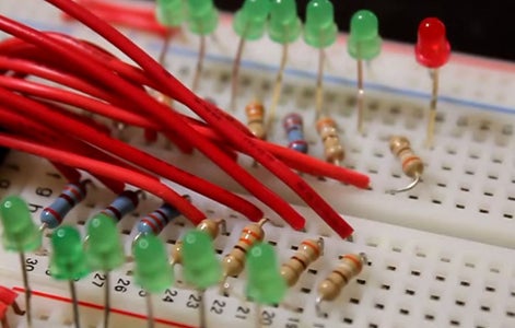

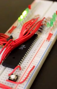

Now we're ready to apply what we know and make an actual game. The game will consist of a couple of push buttons and two sets of LEDs (2 rows of 7). The objective of the game is to see who between two people can push their button the most times in the smallest amount of time. As the button is pressed, the LEDs light up one after the other until the last LED is lit and that side wins. The winner is indicated by the LEDs on their side flashing.
The circuit consists of two rods of LEDs, 7 on each row. Since there are seven on each side, a single port is able to be used for each set with ample room for a push button on each port. One push button and seven LEDs can be wired to eight pins or one port of pins. In the video we use Port B for one player's button and LEDs and port D for the other player's button and LEDs.
