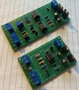

Step 1: Microcontroller PCB Design
To keep the comparison between the microcontroller and 555 based DC motor speed controller fair I decided to use a microcontroller with the same footprint as the 555 timer, an 8-pin dual inline package (DIP).
The Microcontroller PCB is a very simple design especially as I used the internal clock on the PIC12F1840 Microcontroller keeping the component count as low as possible.
The key components of this PCB are:
- The PCB is powered by a 9V battery. 9V goes directly to the positive motor motor terminal to power the motor. The 9V gets reduced to 5V to via an LM7805 linear regulator to power the micro controller.
- The 0-5V Signal voltage goes directly to pin 7 of the microcontroller (RA0) however if you can use a 0-10V signal that gets reduced in half by a voltage divider (R1 and R2). There's three header pins of which you connect the middle pin to with a jumper connector depending on which signal voltage you want to use.
- The Output of the micro controller is used to drive a NPN transistor which in-turn is used to drive a MOSFET which controls the power supplied to the motor.

Step 3: 555 PCB Design
This circuit can really be thought of as 2 stages. Stage 1 is a linear ramp generator (sawtooth wave) and Stage 2 is a comparator stage which gives the PWM output to the DC motor.
Stage 1 - Linear Ramp Generator (Sawtooth Wave)
In this stage the 555 circuit is based on a sawtooth wave generator. The sawtooth wave is generated by charging up a capacitor through a PNP transistor which results in linear charging of the capacitor (a constant current source by passing through a transistor). By changing the values of the resistors and capacitors you can change the frequency of the sawtooth wave output.
As the capacitor charges through the PNP transistor it reaches 2/3 of the 555 supply voltage. When it reaches 2/3 supply voltage it activates the threshold voltage of the 555 which causes the capacitor to discharge through the internal transistor of the 555.
The control pin of the 555 is connected to the output of the 555 so that the bottom of the sawtooth wave goes down closer to zero volts, about 0.2V.
Stage 2 - PWM Output Stage
Once the sawtooth wave has been generated the sawtooth wave is fed into an operational amplifier being used an a comparator. The LM358 operational amplifier works as a comparator by comparing two input voltages. The sawtooth wave is fed into the inverting input (−) and the 0-5V signal is fed into the non-inverting input (+). The 0-5V is reduced down to 0- 3.3V through a voltage divider before it enters the Op Amp. If the LM358 non-inverting input (+) is higher than the inverting input (−), the output goes high. If the inverting input (−) is higher, the output goes low, the output is a square wave. The signal voltage controls how long the output of the Op Amp is high. As the voltage of the sawtooth wave ramps up it increases until it is greater than the signal voltage at this point it turns the output off. At this point the width of the LM358 output is inversely proportional to the signal voltage.
The output of the Op Amp drives the IRFZ44 MOSFET. The motor positive terminal is always connected to the positive voltage (9V on my design) and when the MOSFET is turned on it connects the other motor terminal to ground therefore allowing current to flow through the motor coil.

Step 4: Testing
To test both speed controllers I used my Signal Generator. The signal generator I use is designed for setting up or testing industrial controls and can be set to provide 0-5V, 0-10V, 0-20mA and 4-20mA which are standard control signals used in industrial controls. I used the 0-5V setting for testing both circuits.
I used a simple hobby gearmotor for testing purposes however the circuits would be both cable of handling much larger motors because of the size of the MOSFET I utilised.
Both circuits worked fine as expected, please take a look at the two videos to see the Speed Controllers in action.
