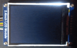

Simply connect the display with 2.4 Inch TFT LCD with ILI9341 to the Raspberry Pi Pico.
When it comes to the LCD's "BL" pin, different versions of the display have different requirements on what to do with it. Some versions specify that it must be connected to the +3.3V, some require it to be grounded, and others allow you to leave it unconnected.

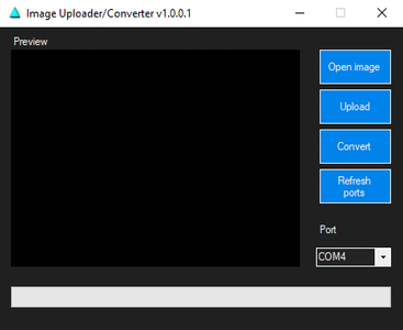

Step 7: Launch the Image Uploader/Converter
Launch the "ImageUploaderConverter.exe" file from the "Software_for_PC" folder.
Note that in order for this software to work you need to have .NET Framework 4.8 installed. You can get it from
https://dotnet.microsoft.com/en-us/download/visual-studio-sdks?cid=getdotnetsdk

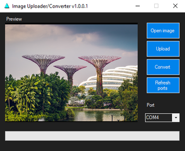

Step 8: Select the Image You Want to Display
After launching the program, click the "Open image" button. In the pop-up window: navigate to the image you'd like to display; select it; and press the "Open" button.
If you need to, you can adjust the image by zooming it in and out.
When you're done adjusting the Image, click the "Upload" button to begin transferring the image to the microcontroller-based digital photo frame.
Step 9: Wait Until the Images Fills the Display
Wait until the display with ILI9341 connected to the microcontroller is filled with the chosen image.
