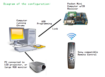

The setup works likes this: (Refer to image two.) My universal remote sends IR signals to my microcontroller. The microcontroller sends commands to control the PC web browser over it's programming cable either as a mouse or by changing pages depending on what buttons I press on the remote. I've seen remotes which are compatible with PC computers as an optional mouse, but this setup is an advanced control system allowing us to send any data/controls to the PC. The system we're building will allow the remote control to act as mouse and software control with plenty of room for your own enhancements.

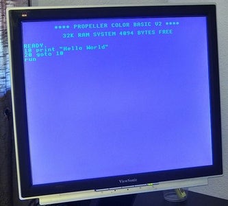

The Pocket Mini Computer is language compatible with Spin, Assembly (PASM), C, and BASIC.
COLOR BASIC features:
- 4094 available bytes free
- 64 and 256 color modes
- 1 "SIDlike" audio channel
- 127 character re-programmable character set
- plot, line, and box graphics commands
- I/O access commands
- 95+ BASIC Commands, operators, and functions
- SD operating system
- Full screen editor (requires a microSD card.)
- Ability to execute non-basic binary programs
- Extended memory features (requires a 23K256 SRAM chip)

2) Open BASIC3 and use F11 to write the required lower EEPROM data to the PMC. Once the program has run, the Pocket Mini Computer should start with a friendly screen and READY. prompt.
3) Before leaving the Propeller Tool, press F7 to identify the COM port which is being used. Write this down for now.
Once you've installed the required firmware on the Pocket Mini Computer, it's time to load the BASIC program.
Download TV.BAS and copy it to the microSD card used by the Pocket Mini Computer. Once it's installed, from BASIC you can type:
LOAD "TV.BAS"
RUN
Yes, it's BASIC. The BASIC on the Pocket Mini Computer is both very easy to understand, yet powerful enough to do complex jobs. Go ahead, LIST the program and take a look. I've tried to keep the program as simple as possible so you can add your own ideas.

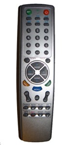

Step 5: Configure the Universal Remote
If you are using the Universal Remote Control supplied by Propellerpowered, these instructions are exact. If you are using another compatible universal remote control, then use the instructions provided with it to configure it in "Sony" TV mode.
Here's how to program the remote.
- Press SET and TV1 together
- Press 0 0 0
- Press SET and VCR together
- Press 0 0 0

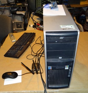

Step 7: Putting It All Together
1) Connect the Pocket Mini Computer to the computer to be used as the Media Center
2) Load the AAC KEY software & set it's COM to match the connection used by the PMC.
3) Set the BAUD rate of AAC KEY to 1200 Baud.
4) Load the file "TV.BAS" on the Pocket Mini Computer and RUN it.
5) Open Chrome on the PC. Chrome will be the basis for our media center software.
Instructions for use:
The program starts in MOUSE Mode. The 4 large AUDIO/VIDEO (92,94,116,117) keys act as a mouse and the MENU (96) button acts as the right mouse button. CH+/CH- (16,17) act as browser forward/backward buttons. Pressing the TV/CATV (56) button will switch to Page Selection Mode.
In Page Selection Mode, pressing the numbers 1-7 will change the page on the browser to Netflix, Crackle, Hulu, NBC, ABC, Weather Channel. Pressing the mouse movement buttons will send it back into Mouse mouse.
You should be able to move the mouse around the screen, click on a link, play a video and or change pages.
Step 8: Modifying the Code
Using the IR Codes Reference picture (second photo), you can change IR buttons (the IF A = lines) and add commands of your own. Refer to the GIDEI Standards page for all of the commands you can send to your computer.

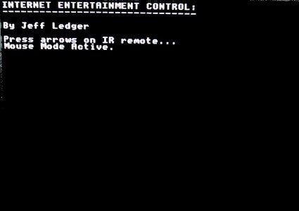

Here's a printout of the BASIC program:
1 COLOR 254,0
2 CLS
10 PRINT "INTERNET ENTERTAINMENT CONTROL:"
20 PRINT "-------------------------------"
30 PRINT " " : PRINT "By Jeff Ledger" : PRINT " "
40 PRINT "Press arrows on IR remote..."
100 SERIAL 31,30,0,1200
105 PRINT "Mouse Mode Active."
110 a=IRCODE
120 IF a = 117 THEN TX 27;",move,-10,0."
130 IF a = 116 THEN TX 27;",move,+10,0."
140 IF a = 94 THEN TX 27;",move,0,-10."
150 IF a = 92 THEN TX 27;",move,0,+10."
160 IF a = 96 THEN TX 27;",click."
170 IF a = 56 THEN GOTO 210
180 IF a = 16 THEN TX "pgup."
181 IF a = 17 THEN TX "pgdn."
200 GOTO 110
210 PRINT "Page Selection Mode Active."
220 a=IRCODE
230 IF a = 37 THEN GOTO 105
240 IF a = 0 THEN GOTO 310
250 IF a = 1 THEN GOTO 320
255 IF a = 2 THEN GOTO 330
260 IF a = 3 THEN GOTO 340
270 IF a = 4 THEN GOTO 350
280 IF a = 5 THEN GOTO 360
290 IF a = 6 THEN GOTO 370
297 IF a = 117 OR a = 116 OR a = 94 OR a = 92 THEN GOTO 105
298 IF a = 117 THEN TX 27;",combine,alt,left."
299 IF a = 116 THEN TX 27;",combine,alt,right."
300 GOTO 220
310 GOSUB 1000
312 TX "www.netflix.com"
314 GOTO 220
320 GOSUB 1000
322 TX "www.crackle.com"
324 GOTO 220
330 GOSUB 1000
332 TX "www.hulu.com"
334 GOTO 220
340 GOSUB 1000
342 TX "www.cbs.com/video"
344 GOTO 220
350 GOSUB 1000
352 TX "abc.go.com/watch?noredirect"
354 GOTO 220
360 GOSUB 1000
362 TX "www.fox.com/full-episodes"
364 GOTO 220
370 GOSUB 1000
372 TX "www.weather.com/weather/right-now/44667:4:US"
374 GOTO 220
1000 TX 27;",combine,control,w ."
1010 PRINT "New Page Selected."
1015 TX 27;",combine,control,t ."
1120 RETURN
