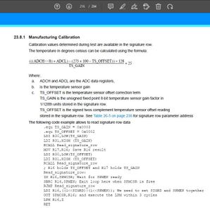

Arduino UNO - open the arduino IDE . According to the datasheet here(link here to the pdf) on page 216, and from the reference of the code www.engineersgallery.com/arduino-internal-temperature-sensor , I make a new code to do the connection to microSD card module. Uno do not have the capability to store the data which we will write the temperature. So we have to use the microSD card to make it works.
