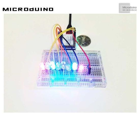

The purpose of designing Microduino was to build a small device to monitor server room temperature remotely. I actually had already built a prototype with Arduino. However, as you know, the size of Arduino was really big. I searched for smaller Arduino compatible board with no luck, and decided to design my own.
To decrease the board size without sacrificing performance, usability, and extendibility, I split the Arduino-Uno circuit into two parts: the -Core circuit, functioning as an Arduino minimum system, and the -FT232R circuit, communicating between PC and -Core. A U-shape 27 pinout was also well defined and utilized for better functional extension.
Microduino-Core and Microduino-FT232R stacking together matchs the power of Arduino-Uno. the size is small .
Step 2: Remote Temperature Monitor With the First Version Microduino
Afterwards, I designed several other extension boards: -Enc for Ethernet communication; -nRF24 for wireless communication in 2.4G frequency; and a -SD card for recording temperature history.
I stacked the boards together and connected temperature sensor in a standard hole board – BTW, Microduino is compatible with a standard hole board, but Arduino is not. Then, Arduino program was developed to make the device work. With this small device, temperature data can be automatically pushed to internet; so I can even real-time monitor the server room temperature at home. I built 8 sets of this device, and they have been working well till today.

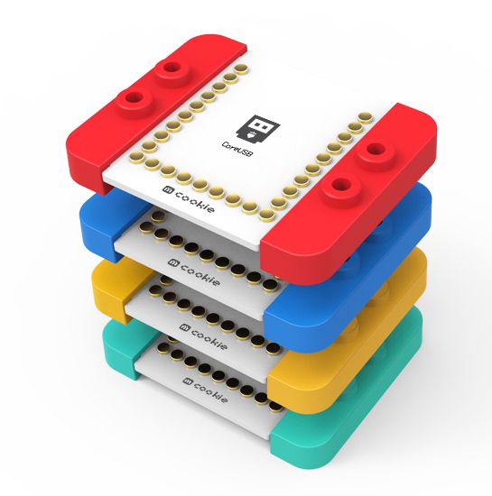

Step 4: Microduino Extension Modules
consequently, I designed a series of Microduino extension modules. Every Microduno module adapt uniformed UPin-27 pinout, and it's well configured across different modules, without any signal conflict.
it's very easy for designers to append various features in your design prototype and idea realization.
