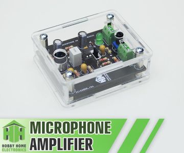

The microphone amplifier schematic diagram and printed circuit board (PCB) were developed in Easy EDA online environment.
The microphone amplifier can work with two or three output electret microphones. Good sound quality is achieved through the use of radio components such as tantalum capacitors and the low noise operational amplifier microcircuit NE5532.
The circuit contains two stages with controlled gain. The gain of the first stage is continuously adjustable by a potentiometer POT1 in the range of 1 ... 10 times. The gain of the second stage can be changed in steps using a jumper JUMP1. If the jumper leads are not shorted together, the gain will be greatest, which is determined by the ratio of R8 and R5 resistors. When a jumper is connected to R6 or R7 in parallel with R8, the gain will be less.

The case of the device for the microphone amplifier was designed in the KOMPAS 3D program. All parts were made of organic transparent glass, 2 mm thick.
Step 6: Installing Brass Racks on the PCB.
Next, on the printed circuit board, we insert brass racks into the holes, with a total length of 12 mm, with an external and internal thread M3, tightening them with brass racks with internal thread M3, 15 mm long on the other side.
Step 7: Installation of Bottom Detail.
From the rear side of the printed circuit board, we install the lower part over the brass racks, tightening everything with M3 screws, 5 mm long.
Step 8: Installation of Side and Top Details.
From the front side, into the rectangular grooves of the lower part, insert 4 side parts, on top of which we install the upper part, fastening everything with M3 screws, 5 mm long.
