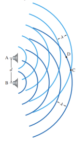

Step 2: Theory
In this project, we will be building a grid of sensors to detect and calculate the angle of waves emitted from the phase delayed speakers. This is achieved by detecting which microphone on the grid has the highest decibel reading then converted to degrees by the microcontroller.
Creating an effective sensor array relies on understanding the basic principles of sound waves and how it affects the microphones. It’s important to learn how to measure sound levels and intensity with acoustic waves, and examine the interactions that occur when waves meet barriers, restrictions, changes to the medium, and other waves.

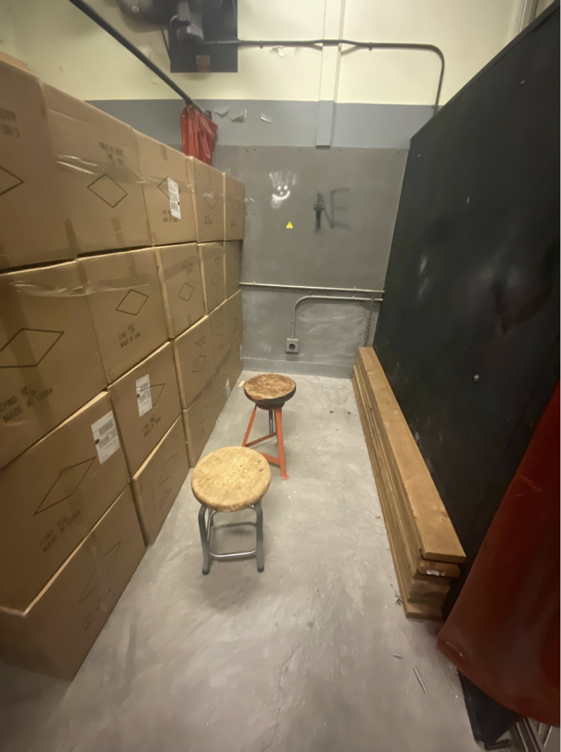

For the microphone array to work properly, it is essential to have a quiet space. If you have a small corner or area that you can block off to isolate from any background noise; try to follow this guide to get a relatively isolated environment.
Step 4: Sound Room: Find a Quiet Place
- A space of your choosing with 3 walls
- Build a 4th wall with cardboard leaving about a foot wide gap for entrance
- Find space with minimum ambient noise
- Measure environment to estimate amount of panels needed (one panel for every square foot of space on the walls)

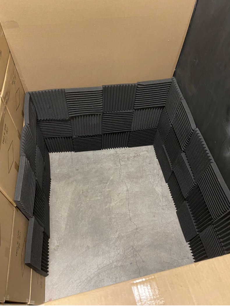

Step 5: Sound Damping Room Planning
Our Sound Damping Room consists of 72 foam sound panels with a blanket on top with a width of 1.39m and a length of 1.16m.
Step 6: Prepare Sound Panels
- Prep Sound Panels
- Remove panels from packaging and soak in water to inflate
- Allow Panels to dry
- Use what you can to secure your sound panels to the walls of your chamber (tape won't work directly on the sound panels)
- We hot glued cardboard to the panels so that tape would stick to them
Step 7: Build Sound Room
- Lay out sound dampening blankets draped over the roof and layed out across the floor
- Secure panels to the wall
Step 8: Building the "Quiet" Room
Drape curtain over the chamber entrance and it's complete!
