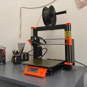

I transferred the sliced file (.gcode) over to a Prusa i3MK3S 3D Printer and started the heating process. As soon as the print bed and extruder reached the right temperatures the 30 minute timer begun and the printer started making my Mic Clip!
