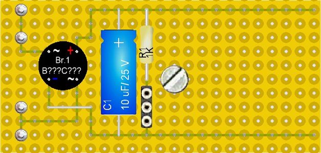

To power the led I decided to make a small circuit. The circuit takes the 6v AC from the secondary coil and rectify it. I also had this capacitor so I added it to stabilize the power a little bit, so the led isn’t flashing. The resistor protects the led from getting over current. Drill a hole through the board and the case and secure the circuit with a screw to the case. Don’t forgot a space holder. Connect the transformer and the led to the circuit. Drill a hole over the main switch and mound the led with the led holder.
