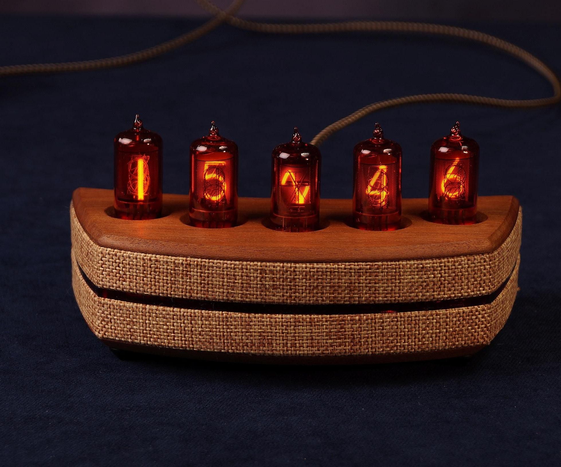

Step 3: Electronics
Clock circuit is quite simple and is based on PIC16F1519 or PIC16F887 micro-controller. Technically, it can be compiled for any other Microchip PIC16 controller in DIP40 package, which has same pinout and also uses internal oscillator. For timekeeping, DS1302 module is being used. You can upgrade to DS3231 module if desired, but of course, you'll need to modify the source code for that. I've also included DS18B20 sensor for temperature measurement and buzzer for alarm function, but these functions currently are not implemented in software, I'm working on code right now.
Nixie cathodes are direct driven, using MPSA42 transistors (30 cascades total). Each transistor drives own cathode, no multiplexing, shift registers, special IC and so on. While this might appear a bit complex, it has two features which gives this clock major edge over competitors. 1. Since direct drive is used, there are no zener diodes for clamping cathodes, as in SN74141 chip, so there are no blue dots, which means more worn and used nixies still can be used. 2. Using direct drive allows for some unique display effects, which simply are not possible using another driving methods.
There are two orange LED's used as time separator. If you want, you can replace them with neon bulbs (Just will need to wire them to high voltage rail and increase resistor from 1K to 1M), and I initially was planning to use them, but all Russian neon tubes which I bought off ebay for that purpose, were too dim when powered from 170V, so I used LED's instead.
PCB is approximately 100x70mm in size and uses all thru-hole components, no SMD or other, tiny or fragile parts. As you can see, all tube connections are routed to PCB sides and PCB has clear marking, showing which group of cathodes where to be connected (A - tens of hours, B - ones of hours, C - tens of minutes, D - ones of minutes). This was done in such way, because in initial design, I had another PCB on top of main PCB, which housed IN-14 Nixies, so clock would have typical nixie clock design. But since that design was abandoned, new Nixie tubes were directly connected to main PCB. Please note: You might have to mirror PCB image, depending on the method of PCB manufacturing.
I decided to use factory made high voltage converter for nixie anode power supply – this is much simpler and safer way to get desired voltages. You can use any available, or make your own – that is not critical. Just search ebay for "Nixie tube power supply". I've used UC3845 based one, but you can pick up another, say MC34063A based.
To power things up, I'm using some cheap 12V 0.5A power supply. Of course, you can use one with higher output current and voltage, but I suggest not to use weaker one. Any DC power supply, capable of delivering 12-15 volts with at least 0.5A of output current will be just fine.

Step 4: Woodworking and Inserts
Clock case is made from pre-cut and glued plywood sheets, which are covered with retro style speaker cloth. Front and rear panels are cut out from wood and plexiglass sheet. Another plexiglass sheet serves as "chassis" for nixie tube sockets and PCBs. Location and alignment of internal components are not critical, you can re-arrange them whatever way you like.
I've cut out clock body parts from plywood sheet, and glued them together with wooden glue. After it all dried, case was sanded from outside, using 600 grit sandpaper, to smooth surfaces and remove glue residue. As I said above, in parts description, you can use plywood or wood material of any thickness, but total thickness of assembled frame should be about 80mm, to fully accommodate both PCB, mounting frame and have adequate space for Nixie tube installation. Also please note, one plywood panel, one that goes to front side, is different from others – it has cutouts in shape of mainframe, so it can be installed from the front.
After body assembly was completed, cloth was glued around it, but used epoxy to fix it on clock body. The reason is that I wanted cloth to be stretched finely, so it won't move. To achieve this, I did the gluing process in the following way: Glued one edge of cloth to body from below side, let it dry for 24 hours. Stretched it around, and while holding it stretched, glued with 5 minute quick dry epoxy glue. After it dried, I've glued front and rear sides with wooden glue, as I did in my previous instructable about DIY Bluetooth speaker.
Front and rear panel are CNC cut from the mahogany wood, but you can use any hardwood you like – walnut, sapele, beech, all will look just great. As description says, you can use different types of Nixie tubes within this design, but since all of them have different outer side, you will need to expand holes in front panel, to fit Tesla or Soviet Nixies. You will also need different "chassis" to mount tube sockets on it, but since Tesla and RFT nixie tubes use same sockets, included chassis design can be used for both, but you will need to modify it for IN-4.
When assembling the clock, you will need to glue hex standoffs with epoxy at the areas marked on the picture. If you don't do so, once clock is assembled and you need to take it apart for whatever reason it is, you won't be able to do so – standoff will unscrew, and you won't be able to separate panels apart.
