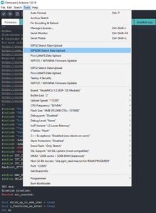

Step 6: Install ESP8266 Filesystem Uploader
The primary purpose of the ESP8266 Filesystem Uploader is to let you upload files into ESP's filesystem. In this tutorial, the purpose of this tool is to upload an empty SPIFFS image into ESP.
Download the archive called ESP8266FS-0.5.0.zip from https://github.com/esp8266/arduino-esp8266fs-plugin/releases
And then extract the content of that archive into the "...\Arduino\Tools\" folder.
After that, restart the Arduino IDE.
Step 7: Format ESP8266's Built-In Flash Memory
Click Tools -> ESP8266 Sketch Data Upload. Then click Yes in the pop-up window. The program is going to format the built-in flash memory.

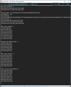

Step 8: Generate Keys
To make the unauthorized deciphering of your data computationally infeasible - It is crucial to generate your own keys and never reuse them
It's entirely up to you how to generate the keys. I can only offer you an option to do so.
I've modified one of my previous projects to work as a random number generator, the generated output seems "random enough" for me, but I haven't run any tests. So, I can't guarantee that it's random.
Use it at your own risk!
To generate the keys - launch gen.exe from the "ESP8266 Version\V2.0\Untested RNG" folder and click the "Gen. keys for Midbar (ESP8266) V2.0" button. The background turns from dark gray to light gray when you press that button.
