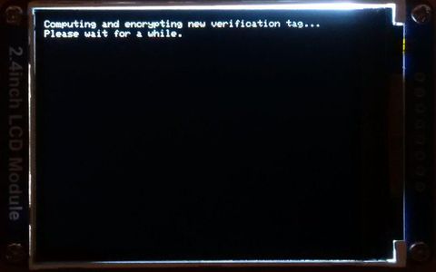

Step 3: EEPROM Integrity Check
Since there's not much space available in the RTL8720DN's flash, I've decided not just to allot a single IV for a record but also to verify the integrity of the whole flash area utilized by the Midbar instead of individually verifying the integrity of each record.

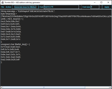

Step 7: Generate Keys
To make the unauthorized deciphering of your data computationally infeasible - It is crucial to generate your own keys and never reuse them
It's entirely up to you how to generate the keys. I can only offer you an option to do so.
I've modified one of my previous projects to work as a random number generator, the generated output seems "random enough" for me, but I haven't run any tests. So, I can't guarantee that it's random.
Use it at your own risk!
To generate the keys - launch gen.exe from the "RTL8720DN Version\V1.0\Untested RNG" folder and click the "Generate keys for Midbar" button. The background turns from dark gray to light gray when you press that button.

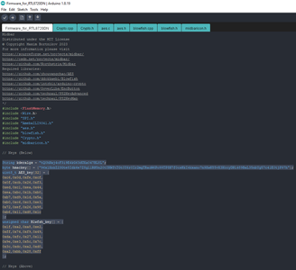

Step 8: Modify Firmware
Open the "Firmware_for_RTL8720DN.ino" file from the "RTL8720DN Version\V1.0\Firmware_for_RTL8720DN" folder, and then replace my keys with those you've generated.

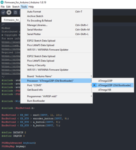

Step 10: Flash Arduino
Upload firmware from the "RTL8720DN Version\V1.0\Firmware_for_Arduino" folder into Arduino.

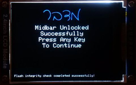

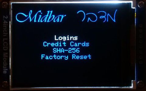

Step 12: Power the Midbar Up
After powering the Midbar up, you should see the word "מדבר" alongside the "Midbar RTL8720DN" and "Press Any Key" inscriptions.
Press any key to get to the next tab.

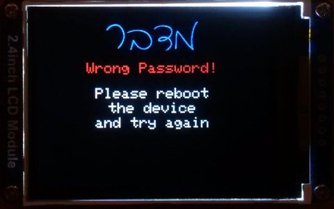

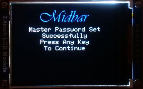

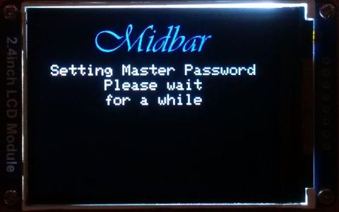

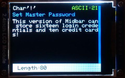

Step 13: Set Master Password
To use the Midbar, you first need to set the master password.
You can't change your master password without performing the factory reset first!
Midbar won't be able to decrypt your data without your master password because the keys for the encryption algorithms are partially derived from it. Perhaps, it won't even unlock without the correct master password.
When you're done entering your master password, either quad-click the encoder button or press the "Enter" on the PS/2 keyboard.
After you've unlocked the vault and got to the main menu:
  • Either turn the rotary encoder to the right or press the "" (DOWNWARDS ARROW) key on the PS/2 keyboard to go down the menu.
  • Either turn the rotary encoder to the left or press the "" (UPWARDS ARROW) key on the PS/2 keyboard to go up the menu.
  • Press either the "A" button or the "Enter" key on the PS/2 keyboard to open the selected menu.
  • While in the submenu, press either the "B" button or the "Esc" key on the PS/2 keyboard to return to the main menu.

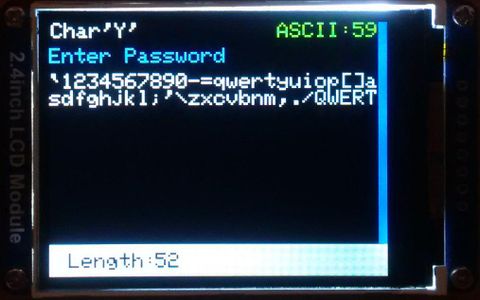

While entering a text in a tab:
  • Either quad-click the encoder button four or press "Enter" on the PS/2 keyboard to continue;
  • Either quintuple-click the encoder button (click it five times in quick succession) or press the "Esc" button on the PS/2 keyboard to cancel the current operation.
*If the hex value decreases when you rotate the encoder to the right, I would advise you to swap the wires connected to the Arduino's "10" and "11" pins.

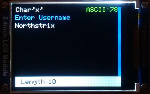

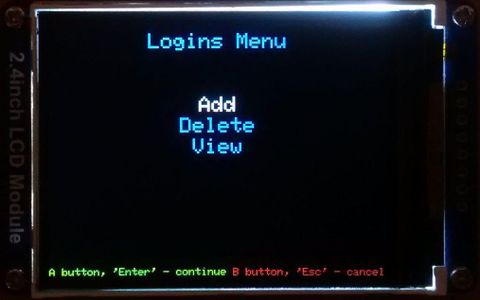

Step 14: Add Login

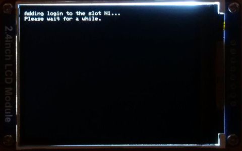

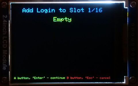

As I've mentioned earlier in this tutorial, this version of Midbar has the ability to store up to 16 login credentials.
To add a login:
  1. Select the "Logins" line in the main menu;
  2. Press either the "A" button or the "Enter" key on the PS/2 keyboard;
  3. Select the "Add" line;
  4. Press either the "A" button or the "Enter" key on the PS/2 keyboard;
  5. Choose the slot you want to put the login to either by rotating the encoder or by pressing the "←" (Leftwards Arrow) and "→" (Rightwards Arrow) keys on the PS/2 keyboard;
  6. Press either the "A" button or the "Enter" key on the PS/2 keyboard;
  7. Enter the username;
  8. Either quad-click the encoder button or press "Enter" on the PS/2 keyboard;
  9. Enter the password;
  10. Either quad-click the encoder button or press "Enter" on the PS/2 keyboard;

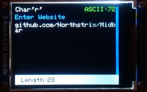

  11. Enter the website;
  12. Either quad-click the encoder button or press "Enter" on the PS/2 keyboard.
*All credentials demonstrated here are entirely fictitious. Any similarity to actual credentials is purely coincidental.

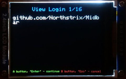

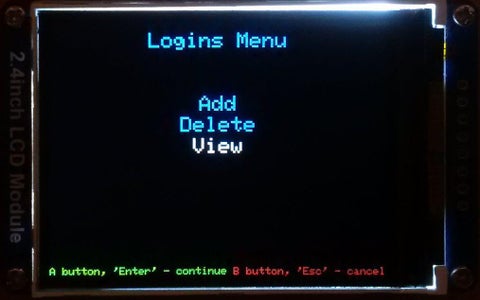

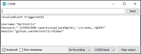

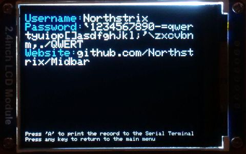

Step 15: View Login
To view a login:
  3. Select the "View" line;
  5. Choose the slot you want to view login from either by rotating the encoder or by pressing the "←" (Leftwards Arrow) and "→" (Rightwards Arrow) keys on the PS/2 keyboard;
  7. Press either the "A" key on the PS/2 keyboard or the "A" button to print the record to the serial terminal.

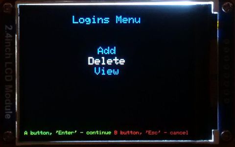

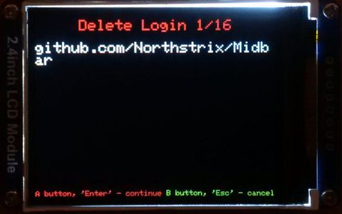

Step 16: Delete Login
To delete a login:
  1. Select the "Logins" line;
  3. Select the "Delete" line;
  5. Select the login you would like to delete either by rotating the encoder or by pressing the "←" (Leftwards Arrow) and "→" (Rightwards Arrow) keys on the PS/2 keyboard;
  6. Press either the "A" button or the "Enter" key on the PS/2 keyboard.
The process of working with credit cards is very similar to the process of working with logins.
