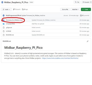

Step 3: Download Firmware
You can download the firmware on my GitHub.

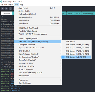

Step 6: Change the "Flash Size" to the "2MB (Sketch: 1MB, FS: 1MB)"
Midbar needs memory allocated for the file system to function.
To allocate the memory for the file system, click "Tools" -> "Flash Size" -> "2MB (Sketch: 1MB, FS: 1MB)"

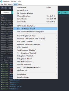

Step 7: Format Raspberry Pi Pico's Built-In Flash Memory
Click "Tools" -> "Pico LittleFS Data Upload." Then click "Yes" in the pop-up window. The program is going to format the RPI's flash memory.

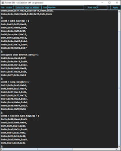

Step 8: Generate Keys
To make the unauthorized deciphering of your data computationally infeasible - It is crucial to generate your own keys and never reuse them
It's entirely up to you how to generate the keys. I can only offer you an option to do so.
I've modified one of my previous projects to work as a random number generator, the generated output seems "random enough" for me, but I haven't run any tests. So, I can't guarantee that it's random.
Use it at your own risk!
To generate the keys - launch gen.exe from the "Untested RNG" folder and click the "Generate keys for Midbar"button. The background turns from dark gray to light gray when you press that button.
