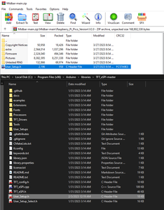

Step 6: Replace the Preset File for the TFT_eSPI Library
TFT_eSPI Library requires the preset file to be modified depending on the display and the board that drives the display. Initially, I wanted to write a mini-guide on choosing and renaming the right preset file for the Raspberry Pi Pico. But then I realized that it would be more convenient to attach the ready-to-use preset file to the firmware and tell you where to place it.
So, take the "User_Setup.h" file from the "Raspberry_Pi_Pico_Version\V2.0" folder and place it in the "C:\Program Files (x86)\Arduino\libraries\TFT_eSPI-master" folder.

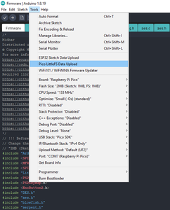

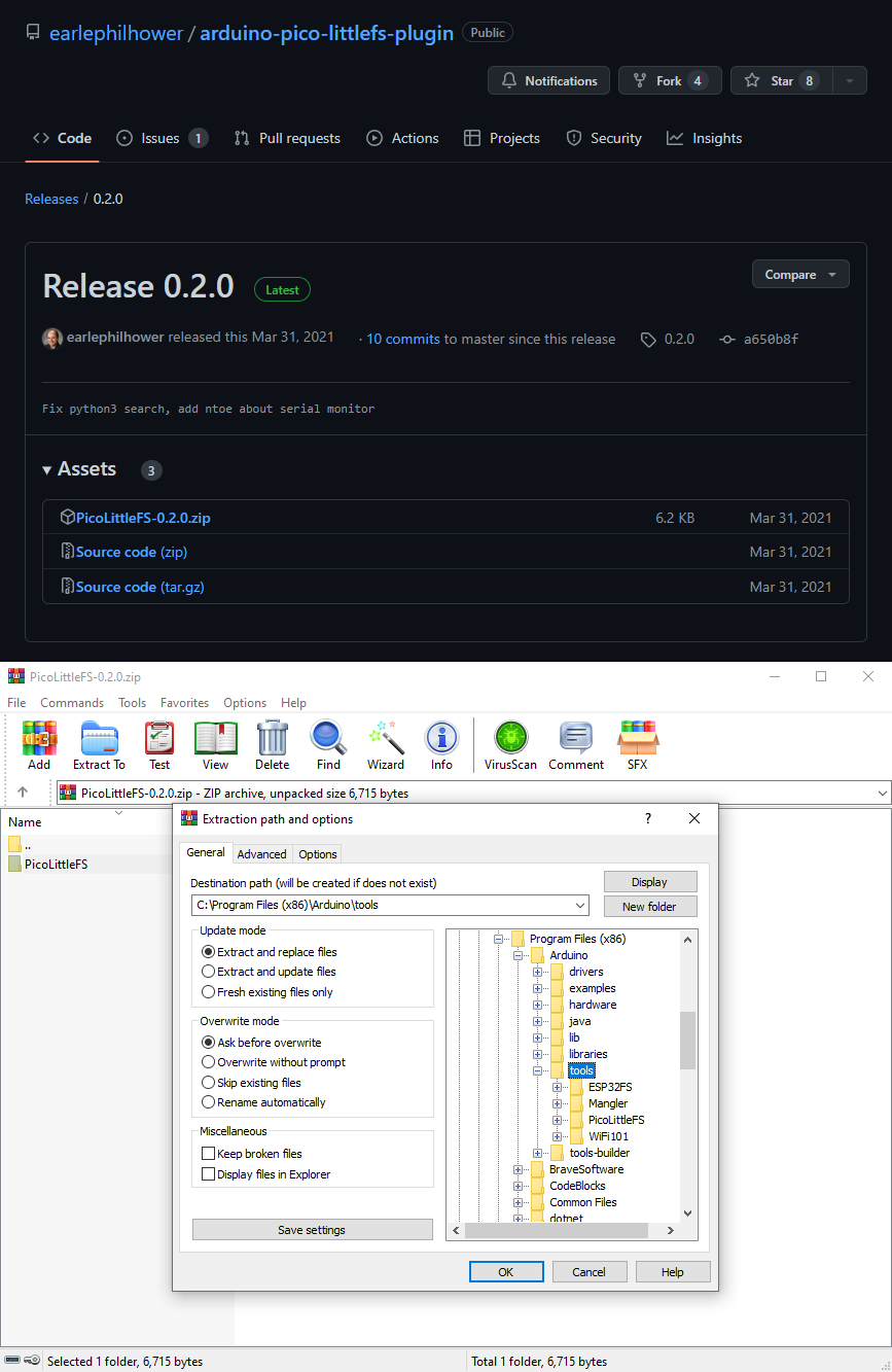

Step 7: Install Arduino-pico-littlefs-plugin
The primary purpose of the arduino-pico-littlefs-plugin is to let you upload the files into the RPI's flash memory. In this tutorial, the purpose of this tool is to format the RPI's flash.
Download the file called PicoLittleFS-0.2.0.zip from https://github.com/earlephilhower/arduino-pico-littlefs-plugin/releases/tag/0.2.0
And then extract the content of the archive into the "...\Arduino\Tools\" folder.
After that, restart the Arduino IDE.

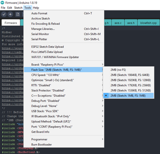

Step 8: Change the "Flash Size" to the "2MB (Sketch: 1MB, FS: 1MB)"
Midbar needs memory allocated for the file system to function.
To allocate the memory for the file system, click "Tools" -> "Flash Size" -> "2MB (Sketch: 1MB, FS: 1MB)"
Step 9: Format Raspberry Pi Pico's Built-In Flash Memory
Click "Tools" -> "Pico LittleFS Data Upload." Then click "Yes" in the pop-up window. The program is going to format the RPI's flash memory.

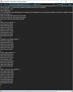

Step 10: Generate Keys
To make the unauthorized deciphering of your data computationally infeasible - It is crucial to generate your own keys and never reuse them
It's entirely up to you how to generate the keys. I can only offer you an option to do so.
I've modified one of my previous projects to work as a random number generator, the generated output seems "random enough" for me, but I haven't run any tests. So, I can't guarantee that it's random.
Use it at your own risk!
To generate the keys - launch gen.exe from the "Raspberry_Pi_Pico_Version\V2.0\Untested RNG" folder and click the "Gen. keys for Midbar (RPI Pico) V2.0" button. The background turns from dark gray to light gray when you press that button.

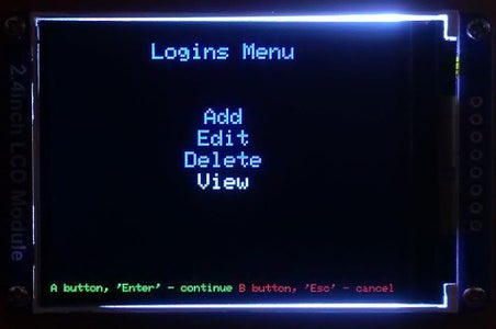

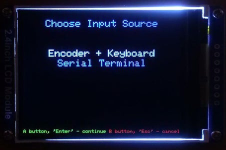

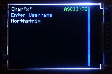

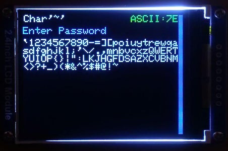

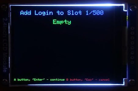

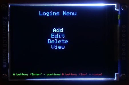

Step 16: Add Login
The Raspberry Pi Pico version of Midbar utilizes the 3DES + AES + Blowfish + Serpent encryption algorithm in CBC mode with an integrity verification feature alongside the LittleFS to keep your data safe and organized.
To add a login from the encoder and PS/2 keyboard:
  1. Select the "Logins" line in the main menu;
  2. Press either the "A" button or the "Enter" key on the PS/2 keyboard;
  3. Select the "Add" line;
  4. Press either the "A" button or the "Enter" key on the PS/2 keyboard;
  5. Choose the slot you want to put the login to either by rotating the encoder or by pressing the "←" (Leftwards Arrow) and "→" (Rightwards Arrow) keys on the PS/2 keyboard;
  6. Press either the "A" button or the "Enter" key on the PS/2 keyboard;
  7. Select the "Encoder + Keyboard" line;
  8. Press either the "A" button or the "Enter" key on the PS/2 keyboard;

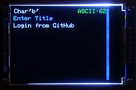

  9. Enter the title;
  10. Either quad-click the encoder button or press "Enter" on the PS/2 keyboard;
  11. Enter the username;
  12. Either quad-click the encoder button or press "Enter" on the PS/2 keyboard;
  13. Enter the password;
  14. Either quad-click the encoder button or press "Enter" on the PS/2 keyboard;

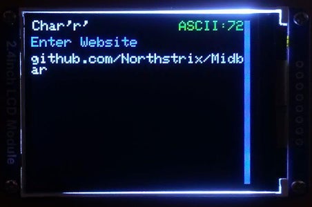

  15. Enter the website;
  16. Either quad-click the encoder button or press "Enter" on the PS/2 keyboard.

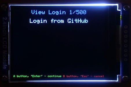

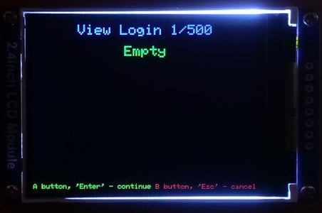

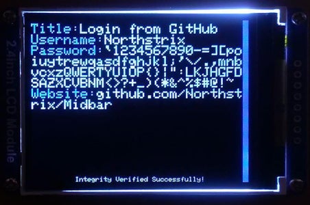

Step 17: View Login
To view a login:
  3. Select the "View" line;
  5. Choose the slot you want to view login from either by rotating the encoder or by pressing the "←" (Leftwards Arrow) and "→" (Rightwards Arrow) keys on the PS/2 keyboard;
  7. Press either the "Tab" key on the PS/2 keyboard or the encoder button to print the record to the serial terminal.
*All credentials demonstrated here are entirely fictitious. Any similarity to actual credentials is purely coincidental.

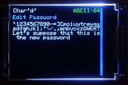

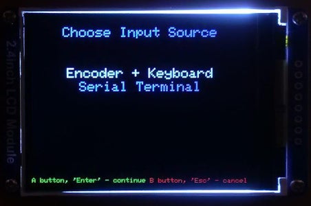

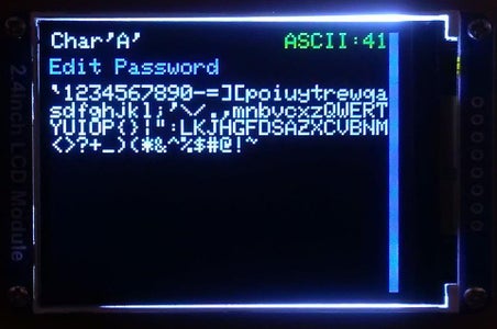

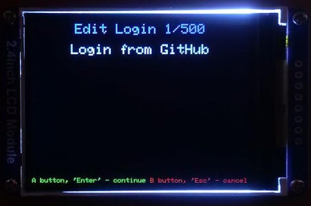

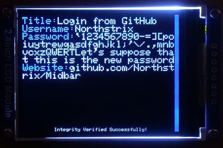

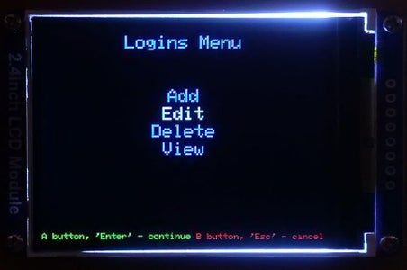

Step 18: Edit Login
To edit a login:
  3. Select the "Edit" line;
  5. Select the login you would like to edit either by rotating the encoder or by pressing the "←" (Leftwards Arrow) and "→" (Rightwards Arrow) keys on the PS/2 keyboard;
  7. Select the input source;
  9. Depending on the chosen input source, either enter the new password you'd like to set on the encoder and PS/2 keyboard or paste it to the Serial Terminal;
  10. Depending on the chosen input source, either quad-click the encoder button (or press "Enter") or press the "Send" button in the Serial Terminal.

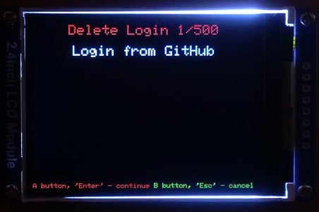

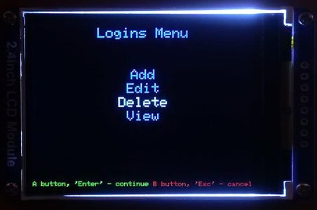

Step 19: Delete Login
To delete a login:
  1. Select the "Logins" line;
  3. Select the "Delete" line;
  5. Select the login you would like to delete either by rotating the encoder or by pressing the "←" (Leftwards Arrow) and "→" (Rightwards Arrow) keys on the PS/2 keyboard;
  6. Press either the "A" button or the "Enter" key on the PS/2 keyboard.
The process of working with records of other types is very similar to the process of working with logins.

  5. Press either the "A" button or the "Enter" key on the PS/2 keyboard;
  6. Select the "Encrypt String" line;
  7. Choose the input source;
  9. Depending on the chosen input source, either enter the text you'd like to encrypt on the encoder and PS/2 keyboard or paste it to the Serial Terminal;
Plaintext:
In case you want to know why I called this project Midbar - Midbar is a Hebrew word that means "pasture," "uninhabited land," "wilderness," "large tracts of wilderness (around cities)," "desert." I had two reasons for choosing the word Midbar as the name of this project. First - while working on my previous projects, I noticed that the so called "device that keeps your personal data secure in an encrypted form" market is pretty much a "desert around the oasis of the password manager market." Second - I couldn't find a better word to describe that project. At first, I wanted to call it a "Password Vault," but then I realized that it's more than just a password vault. So, I just called it Midbar!
Ciphertext:
b32eb64a7e79a02f3da1c75bb8e2a8a0df2ec6bcccaa3fcbe9569bde0acf846f10b9363f5e182c784c7f30bbe4cd58b1ac2fb8afe27a1c3cb2c9892e8253a7be3c076529db7c412c90727246e27d6d94a39d51a8a40a557eff9ce643a45f814f28b87058d4756cdd05704de39029c045a1c5a71f53d104d08379a53ba42f7f468bd38bd53998208741fc4a7351044585fb101f09b17972b3ab1d4e8635fb22bc93236ae34b138e248878053f9ed173b6a7c3939a84883fa9cf8edbefbc804feea9d6f74aa2bcfb6f51308a61fd629f65c95d773579d5d12b12c9e1380c0914a0579a0f872d7995e506f7b2c08510ddeb38ff8c90533692908f16cad88b01d19e7053011468a851404a7a1b66b2243780a678c0ea6ca9dad437ff56a6a1869806e332b1254004548bc574245c43f26eee0e7fa2bb7dd70ac4e036811a4820950d81dc43ea0ff86ee14eefec2ce490987530022fd9d592d780d2378894c1680cdb8d6939502acb657353450e84d38657ba512184cdb138192aea2081f91a595e43b1f09dc2592388e019c405d7592aacba953962f8268de1f40fd0c8463c73cc27fd28dbbd5fd8508adfbd9ba7a55b63f5d36fb808533f2e80fbc41d76d6892146a67f63dd8001dea8241947761ff571c21bb050432fcb076389797e3fada3118775abf694485c1f397e34695e955502f66b8ffd0d66fdfbe5d0a68198b80cc17f35f7437d78eeb7343513dd7fa33fef19ecf3dbbc3a97fe0ebd2df5458595dae82334693ba1efc7975a7bf36f8c26848d3a5efb459fb11c02c469fb0c19b47844d4b5c63614af879e383062d637ab4f493236d75cd92d7ef34177cb856583f4440ac1a411c87bf2efe080cc001cba43bb6b66e19a9a064293647e90aff69ef063e1f2d9515255c1136b5bd4346d822ce2523eca643988149817a1e6eb690cee1850c8c921933b1784097ab474767940c6c6a2800f3f8c457c556f60da34f583a181b1791717d3fbe3db74ddff35babdb2f41f0ffaad78c52194114505b45ef794e9ed99266b02da0410fad215edcf5e7f5a1f49bd6eb786e661691d447ea2da46511790687b82dfa9432ed6027988227234e8156ca997ba23a7e95c2172ebd458311a646b24a145d1fc0b1da2ff1188d11d2893f68462bda8593dd26f3550255294ae1ab12f93aa836b44a574999ce6d52facd1db3b47c1d2883fab530786656a699983e3f1b737f02e3be1db0eeb650dc7b11fe067021bcf0206cfaba01ea56eeaebe2c720d196f3e4742ebc97c02a9ae3b3840f99c754cfac7e05384850f8d463093263ac58cb702a8563df9a95fc45cc5b481dac65849c195b4fca77164573deb82957d157b2dfd13437f979298808c14e7c6781466b65ff6158056178105488250ba372932eaa63f1839ba082045dc1b0abfc278fb9c8092daf0653cc57e0caf6666c3a2a47065bc65933751dcb80ca2f3035b75e97ee19b4b607ec80fd42a6b2f86f71382a40664c8e0a5437bf525caa02e16c6bd885beac21443ef0474b02b533b93d566795e05e8820edea4e3c9fb4d549faec1350d6f552da2d0ff0868bf60d64c33a92bfaaa28e5b7bf9bdbe046f88f66df3c88b699ee1069310feafe3996c3b4e8c80b411b2151612ed261cbb88615d31e63f5eb7a8f212ec43383fcca1f9767601afd4385d87724b19be73d9b7e5b9b31c5503968ea5afb59e0e89
