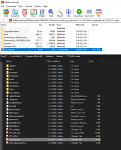

Step 7: Replace the Preset File for the TFT_eSPI Library
TFT_eSPI Library requires the config to be adjusted depending on the display and the board that drives that display. Initially, I wanted to write the mini-guide on adjusting the config for the ST7789 display to be properly used with STM32F401CCU6. But then I realized that it would be more convenient to attach the adjusted config to the firmware and tell you where to place it.
Take the "User_Setup.h" file from the "STM32F401CCU6_and_Arduino_Uno_Version\V1.0" folder and place it in the "C:\Program Files (x86)\Arduino\libraries\TFT_eSPI-master" folder.

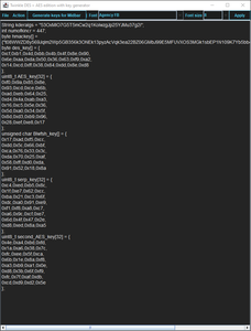

Step 8: Generate Keys
To make the unauthorized deciphering of your data computationally infeasible - It is crucial to generate your own keys and never reuse them
It's entirely up to you how to generate the keys. I can only offer you an option to do so.
I've modified one of my previous projects to work as a random number generator, the generated output seems "random enough" for me, but I haven't run any tests. So, I can't guarantee that it's random.
Use it at your own risk!
To generate the keys - launch gen.exe from the "STM32F401CCU6_and_Arduino_Uno_Version\V1.0\Untested RNG" folder and click the "Generate keys for Midbar" button. The background turns from dark gray to light gray when you press that button.

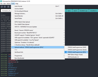

Step 10: Flash STM32F401CCU6
Set the STM32 Black Pill into the bootloader mode by doing the following:
  • Hold the BOOT0 button;
  • Press the NRST button;
  • Release the BOOT0 button.
Make sure that the settings in the "Tools" tab match those on the screen, especially the following settings:
Board: "Generic STM32F4 series"
Board part number: "BlackPill F401CC"
U(S)ART support: "Enabled (generic 'Serial')"
USB support (if available): "CDC (generic 'Serial' supersede U(S)ART)"
Upload method: "STM32CubeProgrammer (DFU)"
And then, upload firmware from the "STM32F401CCU6_and_Arduino_Uno_Version\V1.0\Firmware_for_STM32F401CCU6" folder into the STM32.
You don't need to select the COM port to flash STM32 Black Pill.
