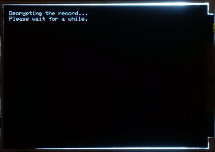

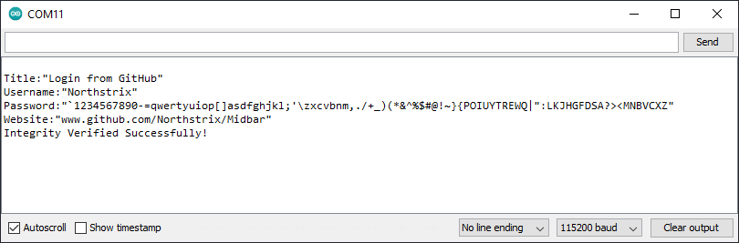

When you add a record to Midbar, it consolidates all the data you have entered into one string, computes a tag for that string, and then saves the newly computed tag in the encrypted form.
When Midbar decrypts your data, it also decrypts the previously saved tag and computes a new one for the decrypted data. It then compares both tags. If they don't match - Midbar notifies you that the integrity verification failed.

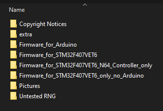

Upon going to the "STM32F407VET6 Version\V1.0" folder, you encounter three folders with the firmware for the STM32F407VET6.
Let me explain the differences between them:
"Firmware_for_STM32F407VET6" is the firmware that contains all the features of this version of Midbar, such as Dual RNG, PS2 keyboard support, and Nintendo 64 Controller support;
"Firmware_for_STM32F407VET6_N64_Controller_only" is the firmware that includes all the features of this version of Midbar except for the PS2 keyboard support.;
"Firmware_for_STM32F407VET6_only_no_Arduino" is the firmware that lacks the Dual RNG feature and the support for the Nintendo 64 Controller. However, it still utilizes the STM32F407VET6's built-in RNG and incorporates all other features. The main pro of this firmware is that it doesn't require pairing the STM32F407VET6 with Arduino.
In this tutorial, I will be using the firmware from the "Firmware_for_STM32F407VET6" folder.

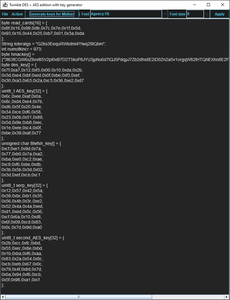

Step 7: Generate Keys
To make the unauthorized deciphering of your data computationally infeasible - It is crucial to generate your own keys and never reuse them
It's entirely up to you how to generate the keys. I can only offer you an option to do so.
I've modified one of my previous projects to work as a random number generator, the generated output seems "random enough" for me, but I haven't run any tests. So, I can't guarantee that it's random.
Use it at your own risk!
To generate the keys - launch gen.exe from the "STM32F407VET6 Version\V1.0\Untested RNG" folder and click the "Generate keys for Midbar" button. The background turns from dark gray to light gray when you press that button.
Step 8: Modify the Chosen Firmware
Open the ".ino" file from the folder with the chosen firmware, and then replace my keys with those you've generated.
You can also change the number of available slots for your data by modifying the value in the "#define MAX_NUM_OF_RECS 999" line, as well as the background color of the inactive elements by modifying the value of the "current_inact_clr" variable.

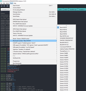

Step 9: Flash STM32F407VET6
After you've chosen the firmware you want to use and made the necessary modifications to it - make sure that the settings in the "Tools" tab match those on the picture above and upload the modified firmware into the STM32F407VET6.

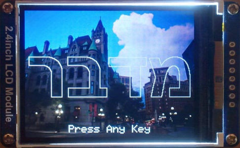

Step 12: Power the Midbar Up
After powering the Midbar up, you should see the word "מדבר" alongside the "Press Any Key" inscription.
The Midbar (STM32F407VET6 Version) has only one lock screen, just like the Midbar (STM32F401CCU6 + Arduino Uno Version) and Midbar (Teensy 4.1 Version) V2.0.
Press any key on the PS2 keyboard or any button on the Nintendo 64 Controller to get to the next tab.

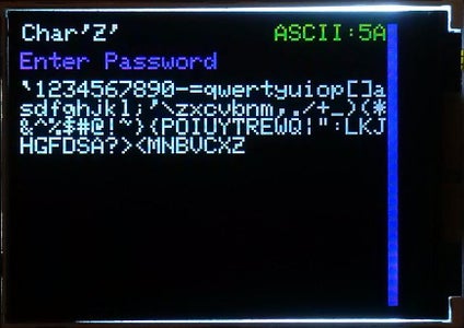

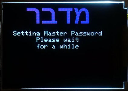

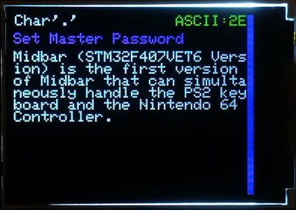

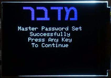

Step 13: Set Master Password
To use the Midbar, you first need to set the master password.
You can't change your master password without performing the factory reset first!
Midbar won't be able to decrypt your data without your master password because the keys for the encryption algorithms are partially derived from it. Perhaps it won't even unlock without the correct master password.
When you're done entering your master password, press either the "Enter" or the "ESC" key on the PS/2 keyboard.
As for the Nintendo 64 controller:
  • The "Start" button acts as the "Enter" key on the PS/2 keyboard;
  • The "Z" button acts as the "Esc" key on the PS/2 keyboard;
  • The "A" button acts as the "Continue/Add char" button;
  • The "B" button acts as the "Backspace" key on the PS/2 keyboard;
  • The "D-pad," "C-pad," "L" button, "R" button, and stick function as arrows on the PS/2 keyboard.
So, whether I would be referring to the keys on the PS2 keyboard, note that I also refer to their N64 equivalent.

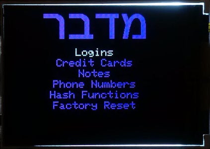

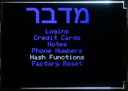

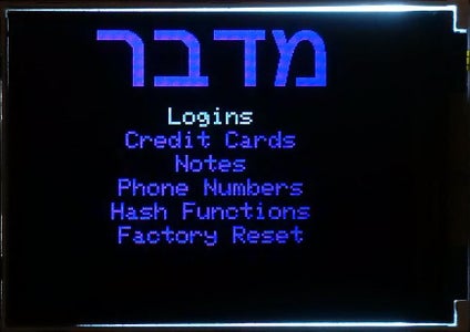

After you've unlocked the vault and got to the main menu:
  • Press the "" (DOWNWARDS ARROW) key on the PS/2 keyboard to go down the menu.
  • Press the "" (UPWARDS ARROW) key on the PS/2 keyboard to go up the menu.
  • Press either the "A" button on the Nintendo 64 Controller or the "Enter" key on the PS/2 keyboard to open the selected menu.
  • While in the submenu, press either the "Esc" or the "Backspace" key on the PS/2 keyboard to return to the main menu.

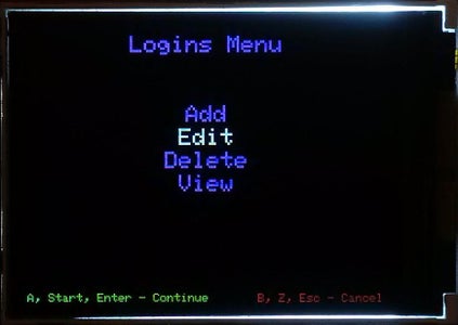

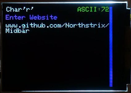

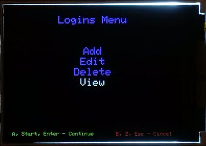

Step 14: Add Login
The Midbar (STM32F407VET6 Version) utilizes the 3DES + AES + Blowfish + Serpent encryption algorithm in CBC mode with an integrity verification feature alongside the SD card to keep your data safe and organized.

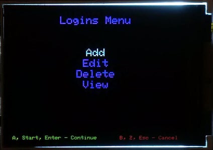

To add a login:
  1. Select the "Logins" line in the main menu;
  2. Press either the "A" button on the Nintendo 64 Controller or the "Enter" key on the PS/2 keyboard;
  3. Select the "Add" line;
  4. Press either the "A" button on the Nintendo 64 Controller or the "Enter" key on the PS/2 keyboard;
  5. Choose the slot you want to put the login to by pressing the "←" (Leftwards Arrow) and "→" (Rightwards Arrow) keys on the PS/2 keyboard;
  6. Press either the "A" button on the Nintendo 64 Controller or the "Enter" key on the PS/2 keyboard;

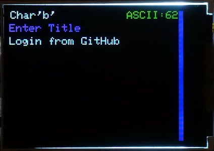

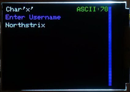

  7. Enter the title;
  8. Press "Enter" on the PS/2 keyboard;
  9. Enter the username;
  10. Press "Enter" on the PS/2 keyboard;
  11. Enter the password;
  12. Press "Enter" on the PS/2 keyboard;
  13. Enter the website;
  14. Press "Enter" on the PS/2 keyboard.
*All credentials demonstrated here are entirely fictitious. Any similarity to actual credentials is purely coincidental.

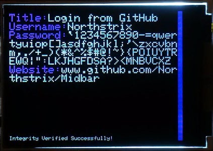

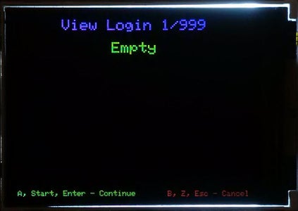

Step 15: View Login

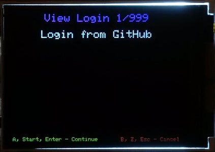

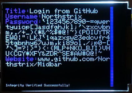

To view a login:
  3. Select the "View" line;
  5. Choose the slot from which you want to view the login by pressing the "←" (Leftwards Arrow) and "→" (Rightwards Arrow) keys on the PS/2 keyboard;
  7. Press either the "" (Upwards Arrow) key on the PS/2 keyboard or the "A" button on the Nintendo 64 Controller to print the record to the serial terminal.

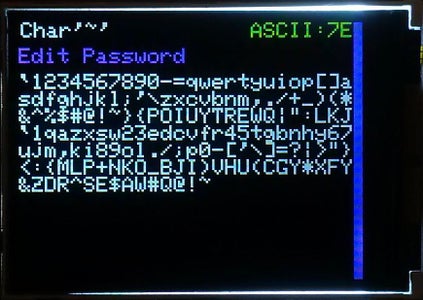

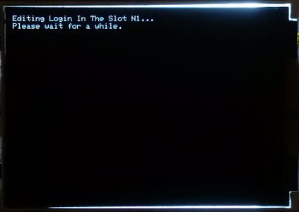

Step 16: Edit Login

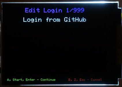

To edit a login:
  3. Select the "Edit" line;
  5. Select the login you would like to edit by pressing the "←" (Leftwards Arrow) and "→" (Rightwards Arrow) keys on the PS/2 keyboard;
  7. Enter the new password;
  8. Press "Enter" on the PS/2 keyboard.

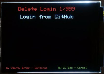

Step 17: Delete Login
To delete a login:
  1. Select the "Logins" line;

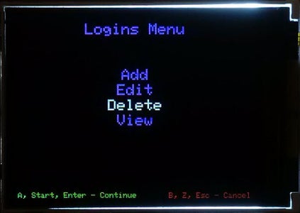

  3. Select the "Delete" line;
  5. Select the login you would like to delete either by pressing the "←" (Leftwards Arrow) and "→" (Rightwards Arrow) keys on the PS/2 keyboard;
  6. Press either the "A" button on the Nintendo 64 Controller or the "Enter" key on the PS/2 keyboard.
The process of working with records of other types is very similar to the process of working with logins.

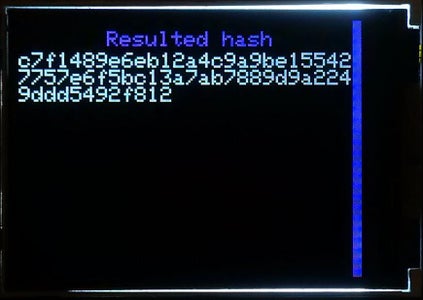

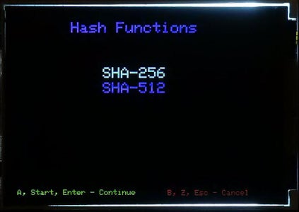

Step 18: Hash String
To hash a string:
  1. Select the "Hash Functions" line in the main menu;
  3. Select the "SHA-256" or "SHA-512" line depending on the hash function you'd like to use;
  5. Enter the string you'd like to hash;
  6. Press "Enter" on the PS/2 keyboard.
