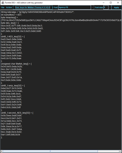

Step 10: Generate Keys
To make the unauthorized deciphering of your data computationally infeasible - It is crucial to generate your own keys and never reuse them
It's entirely up to you how to generate the keys. I can only offer you an option to do so.
I've modified one of my previous projects to work as a random number generator, the generated output seems "random enough" for me, but I haven't run any tests. So, I can't guarantee that it's random.
Use it at your own risk!
To generate the keys for Midbar - launch gen.exe from the "Teensy 4.1 Version\V2.0\Untested RNG" folder and click the "Gen. keys for Midbar (Teensy 4.1) V2.0" button. The background turns from dark gray to light gray when you press that button.

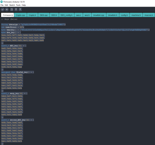

Step 11: Modify Firmware
Open the "Firmware.ino" file from the "Teensy 4.1 Version\V2.0\Firmware" folder, and then replace my keys with those you've generated.
You can also change the number of available slots for the data stored on the SD card by modifying the value in the "#define MAX_NUM_OF_RECS 999" line.

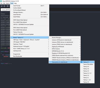

Step 12: Upload the Modified Firmware Into Teensy 4.1
Upload the modified firmware from the "Teensy 4.1 Version\V2.0\Firmware" folder into Teensy 4.1.
Don't forget to set the value of the "USB Type" line to the "Serial + Keyboard + Mouse + Joystick."

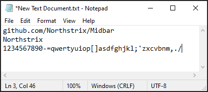

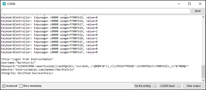

The type feature allows you to use the Midbar (Teensy 4.1 Version) V2.0 as a USB keyboard. In other words, this version of Midbar can input your data to the computer as if you were typing it on a USB keyboard connected to your computer.
To type a login from the EEPROM:
  1. Select the "Logins In EEPROM" line in the main menu;
  2. Press either the "A" button or the "Enter" key on the USB keyboard;
  3. Select the "Type" line;
  4. Press either the "A" button or the "Enter" key on the USB keyboard;
  5. Choose the slot you want to type login from either by rotating the encoder or by pressing the "←" (Leftwards Arrow) and "→" (Rightwards Arrow) keys on the USB keyboard;
  6. Press either the "A" button or the "Enter" key on the USB keyboard;
  7. Press either the "" (Upwards Arrow) key on the USB keyboard or the encoder button to type the website;
  8. Press either the "" (Upwards Arrow) key on the USB keyboard or the encoder button to type the username;
  9. Press either the "" (Upwards Arrow) key on the USB keyboard or the encoder button to type the password.

  12. Either quad-click the encoder button or press "Enter" on the USB keyboard;
  13. Enter the password;
  14. Either quad-click the encoder button or press "Enter" on the USB keyboard;
  15. Enter the website;
  16. Either quad-click the encoder button or press "Enter" on the USB keyboard.

Step 21: View Login From SD Card
To view a login from the SD card:
  1. Select the "Logins On SD Card" line in the main menu;
  3. Select the "View" line;
  5. Choose the slot you want to view login from either by rotating the encoder or by pressing the "←" (Leftwards Arrow) and "→" (Rightwards Arrow) keys on the USB keyboard;
  7. Press either the "" (Upwards Arrow) key on the USB keyboard or the encoder button to print the record to the serial terminal. Note that this feature isn't available for the data stored in the EEPROM.
*All credentials demonstrated here are entirely fictitious. Any similarity to actual credentials is purely coincidental.
