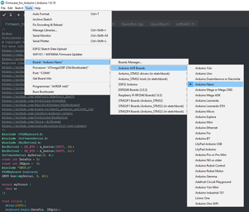

Step 3: Install Drivers and Configure Arduino IDE *Optional
If you've never flashed ESP32 or ESP8266 before you'll need to configure Arduino IDE and install drivers to upload the firmware to the boards, you can find drivers here:

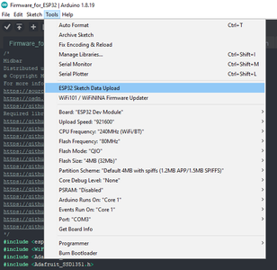

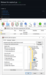

Step 6: Install ESP32 Filesystem Uploader
The primary purpose of the ESP32 Filesystem Uploader is to let you upload files into ESP's filesystem. In this tutorial, the purpose of this tool is to upload an empty SPIFFS image into ESP.
Download the file called ESP32FS-1.0.zip from here: https://github.com/me-no-dev/arduino-esp32fs-plugin/releases/
then extract the content of the archive into the folder: ...\Arduino\Tools\
After that, restart the Arduino IDE.
Step 7: Format ESP32'S Built-In Flash Memory
Click Tools -> ESP32 Sketch Data Upload. Then click Yes in the pop-up window. The program is going format the built-in flash memory.

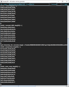

Step 9: Generate Keys
To make the unauthorized deciphering of your data computationally infeasible - It is crucial to generate your own keys and never reuse them
It's entirely up to you how to generate the keys. I can only offer you an option to do so.
I've modified one of my previous projects to work as a random number generator, the generated output seems "random enough" for me, but I haven't run any tests. So, I can't guarantee that it's random.
Use it at your own risk!
To generate the keys - launch gen.exe from the "ESP32 Version\V2.0\Untested RNG" folder and click the "Generate keys for Midbar V2.0" button. The background turns from dark gray to light gray when you press that button.

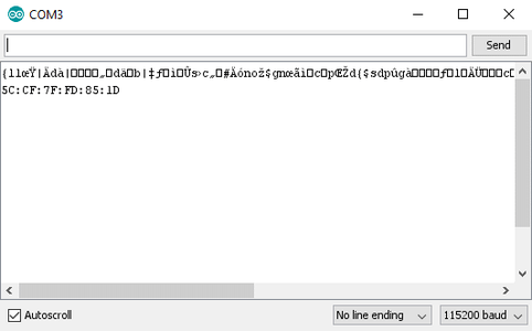

Step 10: Get the Receiver's MAC Address
To get the receiver's MAC address, upload this code into the ESP8266.
#include <ESP8266WiFi.h>
void setup(){
Serial.begin(115200);
Serial.println();
Serial.println(WiFi.macAddress());
void loop(){
Then open the Serial Terminal, and reboot the board.
If done correctly, you should see the MAC address in the console.
The MAC address of this board is 5C:CF:7F:FD:85:1D

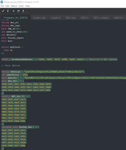

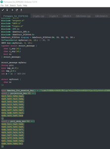

Step 11: Modify the Firmware
Open the "Firmware_for_ESP32.ino" and "Firmware_for_ESP8266.ino" files, and then replace my keys with those you've generated.
Note that the receiver only needs three keys (hmackey_for_session_key, projection_keyproj_serp_key).
Don't forget to replace the receiver's MAC address in the line
uint8_t broadcastAddress[] = {0x5C, 0xCF, 0x7F, 0xFD, 0x85, 0x1D}; // Receiver's MAC address
in the "Firmware_for_ESP32.ino" file.
Step 12: Flash ESP32 (Vault)
Upload the firmware from the "ESP32_Version/V2.0/Firmware for the vault\Firmware_for_ESP32" folder into the ESP32.
Step 13: Flash Arduino (Vault)
Upload the firmware from the "ESP32_Version/V2.0/Firmware for the vault\Firmware_for_Arduino" folder into the Arduino.
Step 14: Flash ESP8266 (Receiver)
Upload the firmware from the "ESP32_Version/V2.0/Firmware for the receiver\Firmware_for_ESP8266" folder into the Arduino.
Step 15: Flash Arduino (Receiver)
Upload the firmware from the "ESP32_Version/V2.0/Firmware for the receiver\Firmware_for_Arduino" folder into the Arduino.

Step 24: Encrypt String
As I've mentioned before, Midbar utilizes seven encryption algorithms. You can use any of them to encrypt your data.
To encrypt text:
  1. Open the Serial Terminal because the ciphertext will be printed to it;
  2. Select the "Encryption Algorithms" line in the main menu;
  3. Press the "A" button;
  4. Select the line with the name of the encryption algorithm you would like to use;
  5. Press the "A" button;
  6. Select the "Encrypt String" line;
  7. Choose the input source;
  8. Press the "A" button;
  9. Depending on the chosen input source, either enter the text you'd like to encrypt on the encoder and PS/2 keyboard or paste it to the Serial Terminal;
  10. Depending on the chosen input source, either quad-click the encoder button (or press "Enter") or press the "Send" button in the Serial Terminal.
Plaintext:
Midbar V2.0 is a password vault, credit card vault, note vault, phone number vault, data encrypter/decrypter, data hasher, SQLite3 host, and one-way secure communication channel - all in one!
Ciphertext:
1a8288a3ae64dacfad456e0cc5547ee070ff45fe005a836b2e99c7c7060e69dc50b9296543531661baee0e64b7e1e3123605b65e5e37ec1ee57403d1f6fb27133f5ff5fd9950190d9f2ca6499d7ffde551277e330667ba527285f8ec9a6e57cbef13d7ddd1bc0b18a666fc47ca3105ad4800b7703ca077f67368933c614472f5c971122d5611dc70181a0dc785d4d9ee968802cbc55184552bcdd9c496dd56cfa3b768ff461c3f49a21c0de08ae182e0ec735596b7b09dc4a3e3c64d8ff478552d0d21e45880e428e09bb6f04c03fbedda1f1159c046536563bef3a7d2df035a3dcc3082b36a1becd63c46b4fc6f452510b73a7b848caa52573eab936a0e4ea020bb4d19f20c1071372a23ec7937f737aa8566d558ac31ce786b28db5f690ec74fd6a0d9ee4958f386e6ddf920d0ed956964d1b2ef6e71d65eeafaf46f595adcacf678313aba118669655d542599f53c3bad540c29f44dff18f5a4974b69f433a6c9947657c30ad57e5c0d0aa6bc851b
Step 25: Decrypt String
To decrypt text:
  1. Open the Serial Terminal because you'll need to paste the ciphertext to it;
  4. Select the line with the name of the encryption algorithm you've used to encrypt the text;
  6. Select the "Decrypt String" line;
  7. Paste the ciphertext to the Serial Terminal;
  8. Press the "Send" button in the Serial Terminal.
Ciphertext:
Plaintext:
