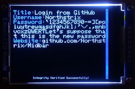

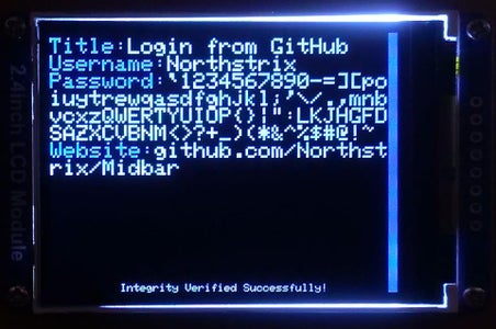

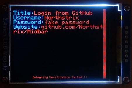

Step 2: Integrity Verification
The Midbar (Raspberry Pi Pico Version) is the third version of Midbar that verifies the integrity of the whole record. So, the legitimate ciphertexts moved between the cells aren't much of a threat to it.
The "HMAC-SHA256"-based integrity verification feature works as follows:
When you add a record to Midbar, it concatenates all the data you've entered into a single string, computes a tag for it, and then stores that tag in the encrypted form.
When Midbar decrypts your data, it also decrypts the previously calculated tag and computes a new tag for the decrypted data. It then compares both tags, and if they don't match - Midbar notifies you that the integrity verification failed.

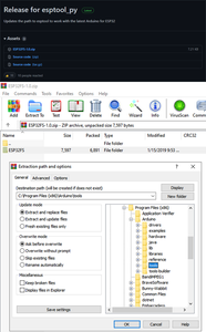

Step 6: Install ESP32 Filesystem Uploader
The primary purpose of the ESP32 Filesystem Uploader is to let you upload files into ESP's filesystem. In this tutorial, the purpose of this tool is to upload an empty SPIFFS image into ESP.
Download the file called ESP32FS-1.0.zip from here: https://github.com/me-no-dev/arduino-esp32fs-plugin/releases/
then extract the content of the archive into the folder: ...\Arduino\Tools\
After that, restart the Arduino IDE.

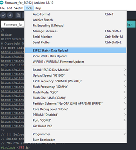

Step 8: Format ESP32'S Built-In Flash Memory
Click Tools -> ESP32 Sketch Data Upload. Then click Yes in the pop-up window. The program is going format the built-in flash memory.
Some boards will flash without any problems.
Unfortunately, that's not the case for all boards. If you configured IDE correctly, installed drivers, selected the corresponding port, and still keep getting this error: A fatal error occurred: Failed to connect to ESP32: Timed out waiting for packet header. Connect a 10µF capacitor to the board while flashing.
Connect the positive lead of the capacitor to the EN pin of the ESP32;
Connect the negative lead of the capacitor (usually indicated by the gray stripe) to the GND pin of the ESP32.
Don't forget to disconnect the capacitor after the board flashes.

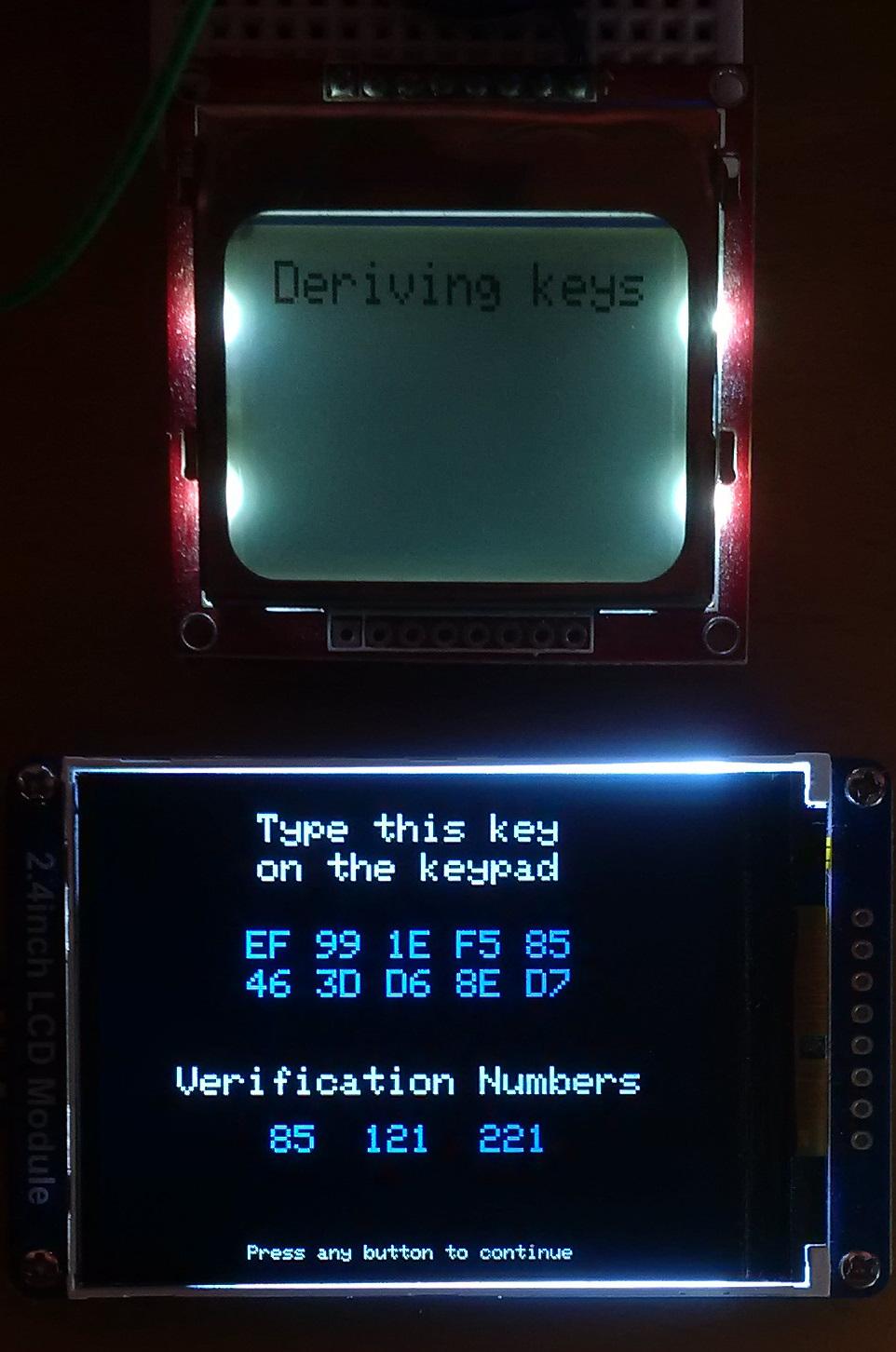

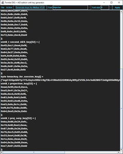

Step 9: Generate Keys
To make the unauthorized deciphering of your data computationally infeasible - It is crucial to generate your own keys and never reuse them
It's entirely up to you how to generate the keys. I can only offer you an option to do so.
I've modified one of my previous projects to work as a random number generator, the generated output seems "random enough" for me, but I haven't run any tests. So, I can't guarantee that it's random.
Use it at your own risk!
To generate the keys - launch gen.exe from the "ESP32_Version\V3.0\Untested RNG" folder and click the "Generate keys for Midbar V3.0" button. The background turns from dark gray to light gray when you press that button.

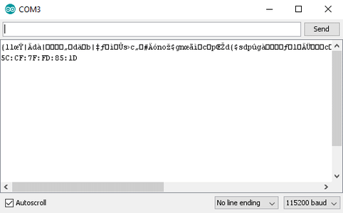

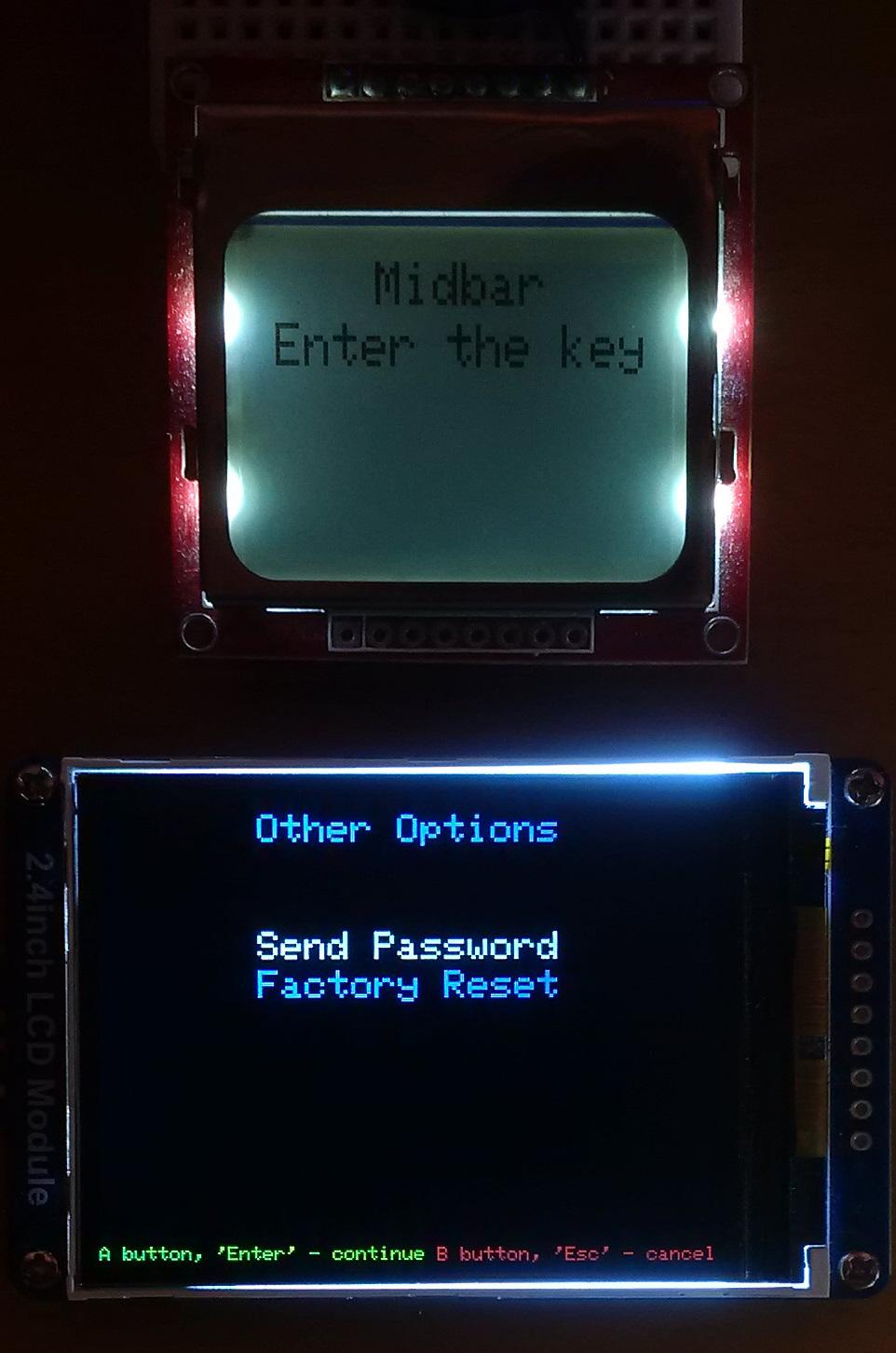

Step 10: Get the Receiver's MAC Address
To get the receiver's MAC address, upload this code into the ESP8266.
#include <ESP8266WiFi.h>
void setup(){
Serial.begin(115200);
Serial.println();
Serial.println(WiFi.macAddress());
void loop(){
Then open the Serial Terminal, and reboot the board.
If done correctly, you should see the MAC address in the console.
The MAC address of this board is 5C:CF:7F:FD:85:1D

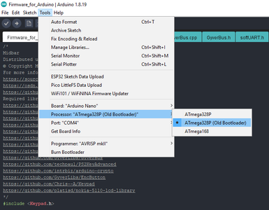

Step 14: Flash Arduino
Upload the firmware from the "ESP32_Version\V3.0\Firmware_for_Arduino" folder into the Arduino.

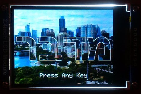

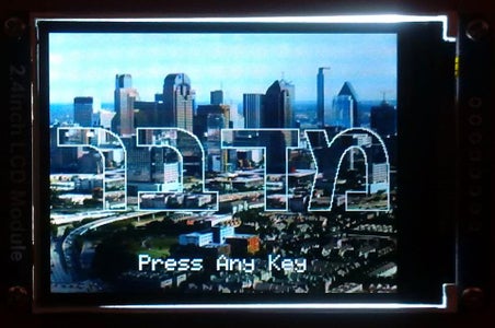

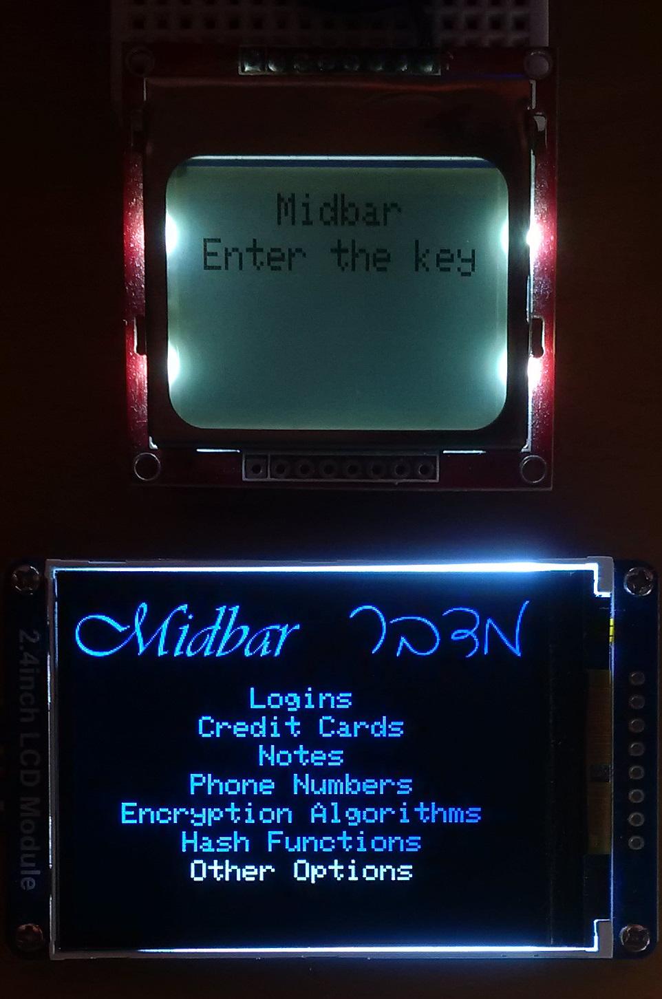

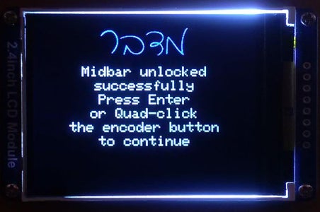

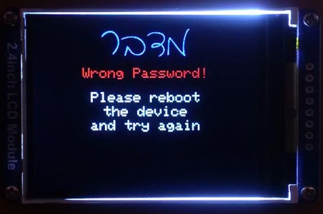

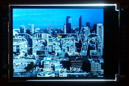

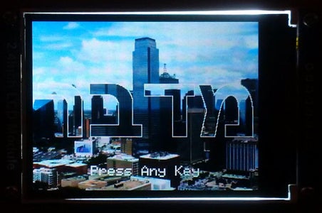

Step 17: Power the Vault Up

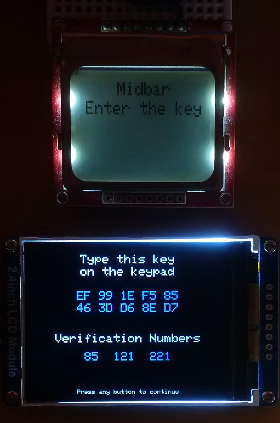

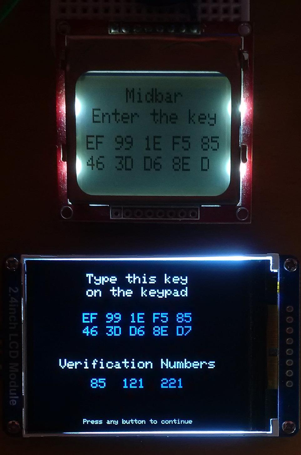

Unlike the Midbar V2.5, which only has one lock screen, the Midbar V3.0 has five. Midbar randomly chooses the lock screen at startup.
After the Midbar has chosen the lock screen, it displays the word "מדבר" with the shifting background and the "Press Any Key" inscription.
At that point, press any key or button to get to the next tab.

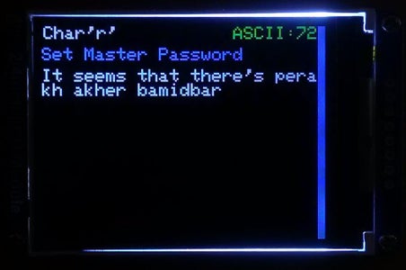

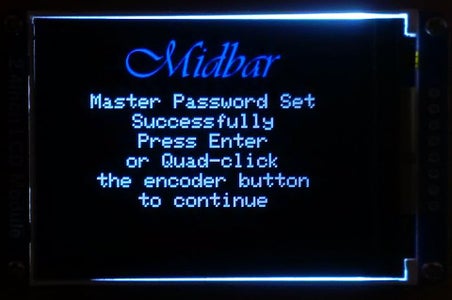

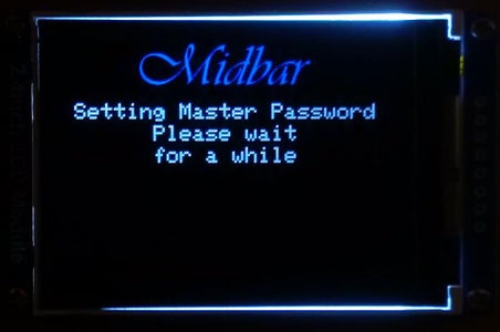

Step 18: Set the Master Password
To use the Midbar, you first need to set the master password.
You can only enter the master password using the encoder and PS/2 keyboard.
And remember that you can't change your master password without performing the factory reset first!
Midbar won't be able to decrypt your data without your master password because the keys for the encryption algorithms are partially derived from it. Perhaps, it won't even unlock without the correct master password.
When you're done entering your master password, either quad-click the encoder button or press the "Enter" on the PS/2 keyboard.

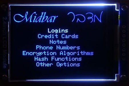

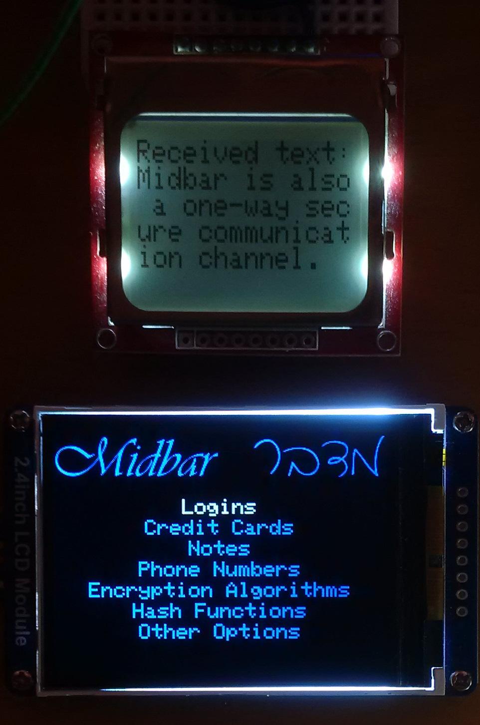

After you've unlocked the vault and got to the main menu:
  • Either turn the rotary encoder to the right or press the "" (DOWNWARDS ARROW) key on the PS/2 keyboard to go down the menu.
  • Either turn the rotary encoder to the left or press the "" (UPWARDS ARROW) key on the PS/2 keyboard to go up the menu.
  • Press either the "A" button or the "Enter" key on the PS/2 keyboard to open the selected menu.
  • While in the submenu, press either the "B" button or the "Esc" key on the PS/2 keyboard to return to the main menu.

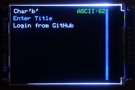

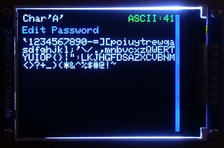

While entering a text in a tab:
  • Either quad-click the encoder button four or press "Enter" on the PS/2 keyboard to continue;
  • Either quintuple-click the encoder button (click it five times in quick succession) or press the "Esc" button on the PS/2 keyboard to cancel the current operation.
*If the hex value decreases when you rotate the encoder to the right, I would advise you to swap the wires connected to the D26 and D27 pins.
And by the way, pressing the "Caps Lock," "Num Lock," or "Scroll Lock" buttons makes the keyboard unresponsive until you either reconnect it or reboot the ESP32.

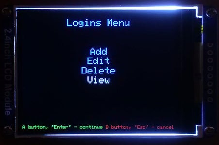

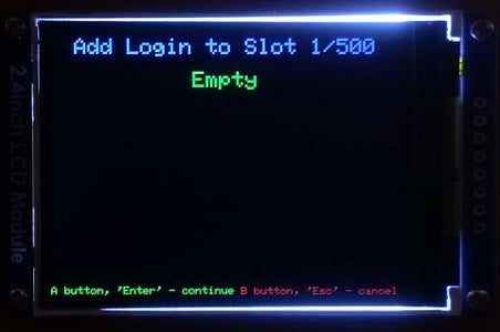

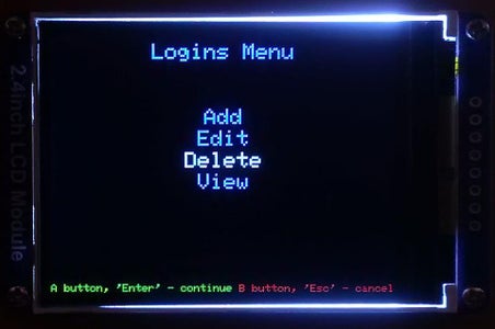

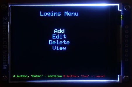

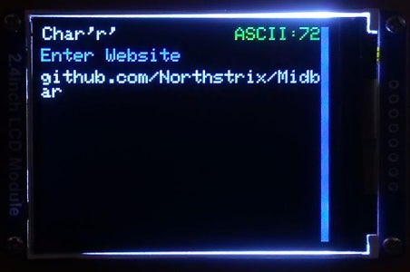

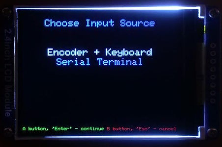

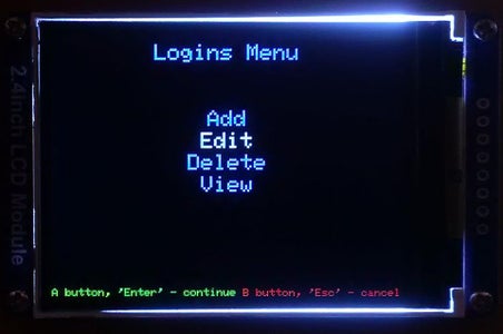

Step 19: Add Login
First and foremost, the Midbar V3.0 is a vault. It utilizes the 3DES + AES + Blowfish + Serpent encryption algorithm in CBC mode with an integrity verification feature alongside the ESP32's built-in flash memory to keep your data safe and organized.

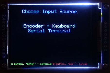

To add a login from the encoder and PS/2 keyboard:
  1. Select the "Logins" line in the main menu;
  2. Press either the "A" button or the "Enter" key on the PS/2 keyboard;
  3. Select the "Add" line;
  4. Press either the "A" button or the "Enter" key on the PS/2 keyboard;
  5. Choose the slot you want to put the login to either by rotating the encoder or by pressing the "←" (Leftwards Arrow) and "→" (Rightwards Arrow) keys on the PS/2 keyboard;
  6. Press either the "A" button or the "Enter" key on the PS/2 keyboard;
  7. Select the "Encoder + Keyboard" line;
  8. Press either the "A" button or the "Enter" key on the PS/2 keyboard;

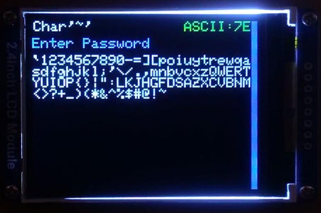

  9. Enter the title;
  10. Either quad-click the encoder button or press "Enter" on the PS/2 keyboard;
  11. Enter the username;
  12. Either quad-click the encoder button or press "Enter" on the PS/2 keyboard;
  13. Enter the password;
  14. Either quad-click the encoder button or press "Enter" on the PS/2 keyboard;
  15. Enter the website;
  16. Either quad-click the encoder button or press "Enter" on the PS/2 keyboard;

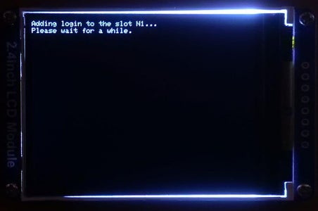

According to the tests I've conducted - Raspberry Pi Pico can encrypt and decrypt a 650-character long string without any problems using the 3DES + AES + Blowfish + Serpent encryption algorithm. So, technically, you can put 650 characters into a field of a record.
*All credentials demonstrated here are entirely fictitious. Any similarity to actual credentials is purely coincidental.

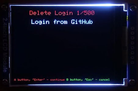

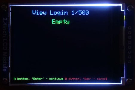

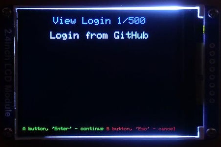

Step 20: View Login
To view a login:
  3. Select the "View" line;
  5. Choose the slot you want to view login from either by rotating the encoder or by pressing the "←" (Leftwards Arrow) and "→" (Rightwards Arrow) keys on the PS/2 keyboard;
  7. Press either the "Tab" key on the PS/2 keyboard or the encoder button to print the record to the serial terminal.

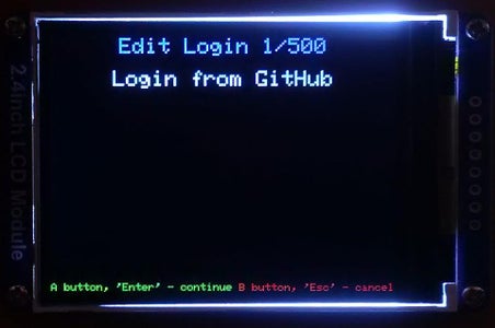

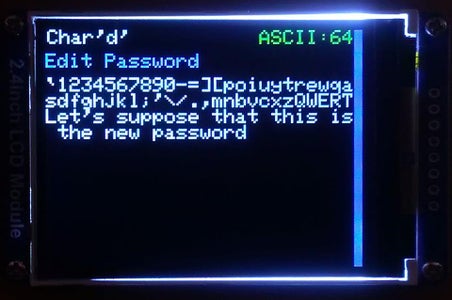

Step 21: Edit Login
To edit a login:
  3. Select the "Edit" line;
  5. Select the login you would like to edit either by rotating the encoder or by pressing the "←" (Leftwards Arrow) and "→" (Rightwards Arrow) keys on the PS/2 keyboard;
  7. Select the input source;
  9. Depending on the chosen input source, either enter the new password you'd like to set on the encoder and PS/2 keyboard or paste it to the Serial Terminal;
  10. Depending on the chosen input source, either quad-click the encoder button (or press "Enter") or press the "Send" button in the Serial Terminal.
Step 22: Delete Login
To delete a login:
  1. Select the "Logins" line;
  3. Select the "Delete" line;
  5. Select the login you would like to delete either by rotating the encoder or by pressing the "←" (Leftwards Arrow) and "→" (Rightwards Arrow) keys on the PS/2 keyboard;
  6. Press either the "A" button or the "Enter" key on the PS/2 keyboard.
The process of working with records of other types is very similar to the process of working with logins.
Step 23: Send Password to the Receiver
I'll be honest with you the receiver firmware didn't change since the Cipherbox V2.0.
To protect the receiver from the replay attack (ensure that the receiver won't correctly decrypt any package that is resent to it) - I've combined the key incrementation with the session key. The session key consists of 20 characters generated by the vault. The session key is valid until you either reboot ESP32 or power it off. After the key derivation process completes, both devices present you with the three verification numbers. These numbers must match on both the vault and the receiver! If these numbers don't match, I would advise you to reboot the ESP8266 and enter the session key again. If that won't work, open the firmware and check if the keys are the same.
To send the password to the receiver:
  • Select the "Other Options" line in the main menu;
  • Press either the "A" button or the "Enter" key on the PS/2 keyboard;
  • Select the "Send Password" line;
  • Enter the key on the receiver's keypad;
  • Compare the verification numbers on both displays. They must be the same;
  • Enter the password you'd like to send on the encoder and PS/2 keyboard;
  • Either press the "Enter" key on the PS/2 keyboard or quad-click the encoder button to send the password to the receiver.
The receiver also prints the received text to the Serial Terminal.
