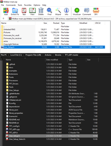

Step 6: Replace the Preset File for the TFT_eSPI Library
TFT_eSPI Library requires the config to be adjusted depending on the display and the board that drives that display. Initially, I wanted to write the mini-guide on adjusting the config for the ILI9341 display to be properly used on the ESP32's HSPI. But then I realized that it would be more convenient to attach the adjusted config to the firmware and tell you where to place it.
Take the "User_Setup.h" file from the "ESP32_Version\V4.0" folder and place it in the "C:\Program Files (x86)\Arduino\libraries\TFT_eSPI-master" folder.

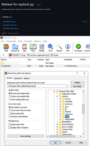

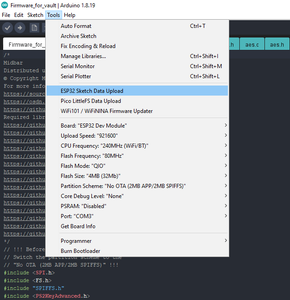

Step 7: Install ESP32 Filesystem Uploader
The primary purpose of the ESP32 Filesystem Uploader is to let you upload files into ESP's filesystem. In this tutorial, the purpose of this tool is to upload an empty SPIFFS image into ESP.
Download the file called ESP32FS-1.0.zip from https://github.com/me-no-dev/arduino-esp32fs-plugin/releases/
And then extract the content of the archive into the "...\Arduino\Tools\" folder.
After that, restart the Arduino IDE.
Step 8: Switch the Partition Scheme to the "No OTA (2MB APP/2MB SPIFFS)"
You have to switch the partition scheme to the "No OTA (2MB APP/2MB SPIFFS)" before you continue working with ESP32 because the firmware for the vault is too big for the default partition.
Step 9: Format Vault'S Built-In Flash Memory
Connect the ESP32 that you're going to use as a core of the vault to the computer. Click Tools -> ESP32 Sketch Data Upload. Then click Yes in the pop-up window. The program is going to format the built-in flash memory.

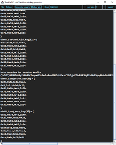

Step 10: Generate Keys
To make the unauthorized deciphering of your data computationally infeasible - It is crucial to generate your own keys and never reuse them
It's entirely up to you how to generate the keys. I can only offer you an option to do so.
I've modified one of my previous projects to work as a random number generator, the generated output seems "random enough" for me, but I haven't run any tests. So, I can't guarantee that it's random.
Use it at your own risk!
To generate the keys - launch gen.exe from the "ESP32_Version\V4.0\Untested RNG" folder and click the "Generate keys for Midbar V4.0" button. The background turns from dark gray to light gray when you press that button.

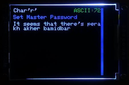

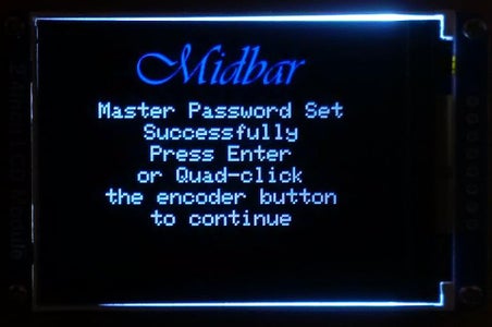

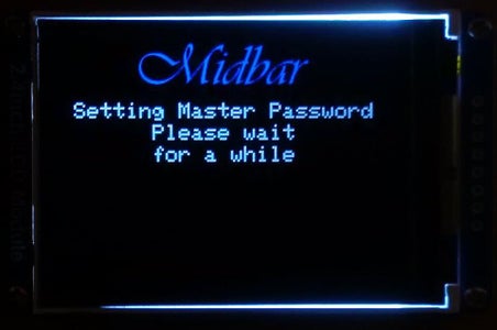

Step 19: Set the Master Password
To use the Midbar, you first need to set the master password.
You can only enter the master password using the encoder and PS/2 keyboard.
And remember that you can't change your master password without performing the factory reset first!
Midbar won't be able to decrypt your data without your master password because the keys for the encryption algorithms are partially derived from it. Perhaps, it won't even unlock without the correct master password.
When you're done entering your master password, either quad-click the encoder button or press the "Enter" on the PS/2 keyboard.

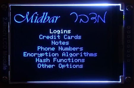

After you've unlocked the vault and got to the main menu:
  • Either turn the rotary encoder to the right or press the "" (DOWNWARDS ARROW) key on the PS/2 keyboard to go down the menu.
  • Either turn the rotary encoder to the left or press the "" (UPWARDS ARROW) key on the PS/2 keyboard to go up the menu.
  • Press either the "A" button or the "Enter" key on the PS/2 keyboard to open the selected menu.
  • While in the submenu, press either the "B" button or the "Esc" key on the PS/2 keyboard to return to the main menu.

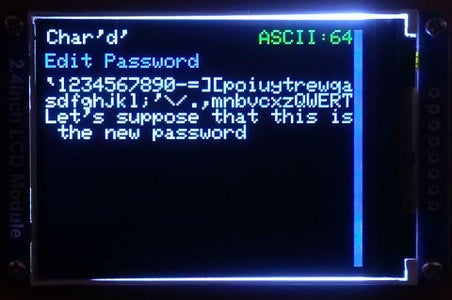

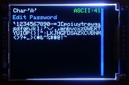

While entering a text in a tab:
  • Either quad-click the encoder button four or press "Enter" on the PS/2 keyboard to continue;
  • Either quintuple-click the encoder button (click it five times in quick succession) or press the "Esc" button on the PS/2 keyboard to cancel the current operation.
*If the hex value decreases when you rotate the encoder to the right, I would advise you to swap the wires connected to the D26 and D27 pins.
And by the way, pressing the "Caps Lock," "Num Lock," or "Scroll Lock" buttons makes the keyboard unresponsive until you either reconnect it or reboot the ESP32.

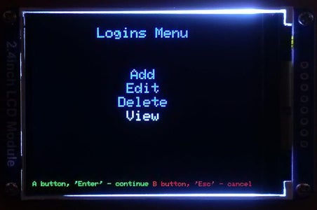

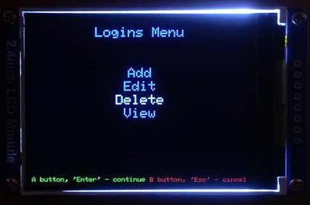

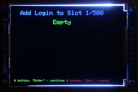

Step 20: Add Login
First and foremost, the Midbar V4.0 is a vault. It utilizes the 3DES + AES + Blowfish + Serpent encryption algorithm in CBC mode with an integrity verification feature alongside the ESP32's built-in flash memory to keep your data safe and organized.

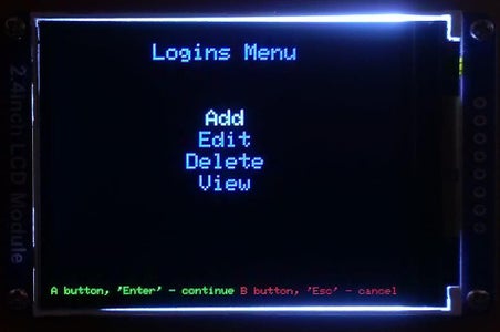

To add a login from the encoder and PS/2 keyboard:
  1. Select the "Logins" line in the main menu;
  2. Press either the "A" button or the "Enter" key on the PS/2 keyboard;
  3. Select the "Add" line;
  4. Press either the "A" button or the "Enter" key on the PS/2 keyboard;
  5. Choose the slot you want to put the login to either by rotating the encoder or by pressing the "←" (Leftwards Arrow) and "→" (Rightwards Arrow) keys on the PS/2 keyboard;
  6. Press either the "A" button or the "Enter" key on the PS/2 keyboard;

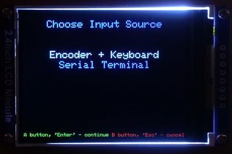

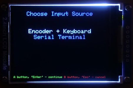

  7. Select the "Encoder + Keyboard" line;
  8. Press either the "A" button or the "Enter" key on the PS/2 keyboard;

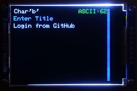

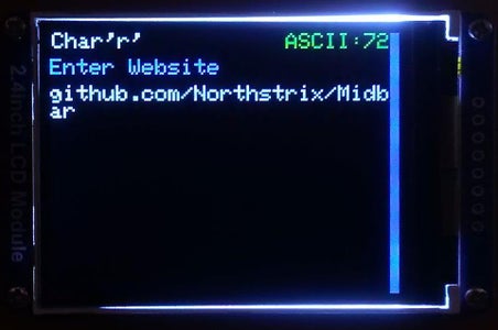

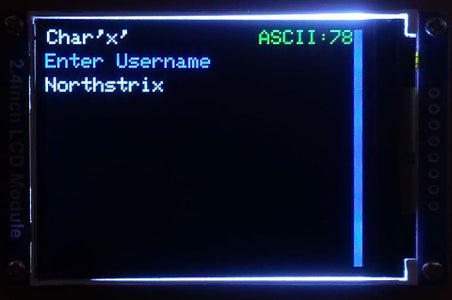

  9. Enter the title;
  10. Either quad-click the encoder button or press "Enter" on the PS/2 keyboard;
  11. Enter the username;
  12. Either quad-click the encoder button or press "Enter" on the PS/2 keyboard;
  13. Enter the password;
  14. Either quad-click the encoder button or press "Enter" on the PS/2 keyboard;
  15. Enter the website;
  16. Either quad-click the encoder button or press "Enter" on the PS/2 keyboard.

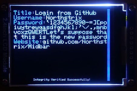

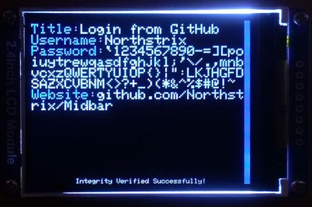

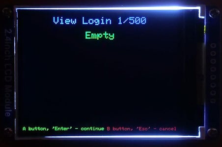

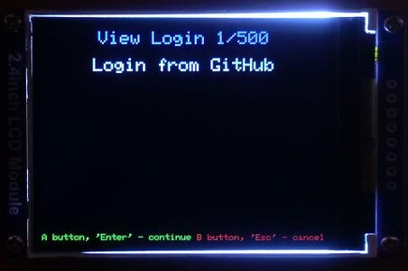

Step 21: View Login
To view a login:
  3. Select the "View" line;
  5. Choose the slot you want to view login from either by rotating the encoder or by pressing the "←" (Leftwards Arrow) and "→" (Rightwards Arrow) keys on the PS/2 keyboard;
  7. Press either the "Tab" key on the PS/2 keyboard or the encoder button to print the record to the serial terminal.
*All credentials demonstrated here are entirely fictitious. Any similarity to actual credentials is purely coincidental.

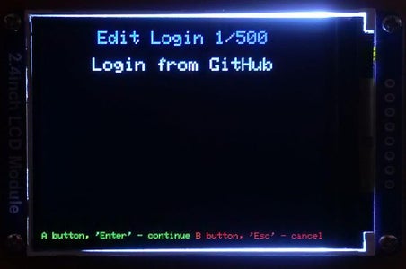

Step 22: Edit Login
To edit a login:
  3. Select the "Edit" line;
  5. Select the login you would like to edit either by rotating the encoder or by pressing the "←" (Leftwards Arrow) and "→" (Rightwards Arrow) keys on the PS/2 keyboard;
  7. Select the input source;
  9. Depending on the chosen input source, either enter the new password you'd like to set on the encoder and PS/2 keyboard or paste it to the Serial Terminal;
  10. Depending on the chosen input source, either quad-click the encoder button (or press "Enter") or press the "Send" button in the Serial Terminal.

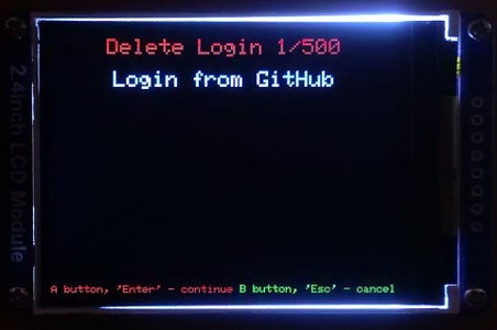

Step 23: Delete Login
To delete a login:
  1. Select the "Logins" line;
  3. Select the "Delete" line;
  5. Select the login you would like to delete either by rotating the encoder or by pressing the "←" (Leftwards Arrow) and "→" (Rightwards Arrow) keys on the PS/2 keyboard;
  6. Press either the "A" button or the "Enter" key on the PS/2 keyboard.
The process of working with records of other types is very similar to the process of working with logins.

  • Select the "Other Options" line in the main menu;
  • Press either the "A" button or the "Enter" key on the PS/2 keyboard;
  • Select the "Send Password" line;
