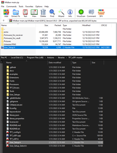

Step 5: Replace the Preset File for the TFT_eSPI Library
TFT_eSPI Library requires the config to be adjusted depending on the display and the board that drives that display. Initially, I wanted to write the mini-guide on adjusting the config for the ILI9341 display to be properly used on the ESP32's HSPI. But then I realized that it would be more convenient to attach the adjusted config to the firmware and tell you where to place it.
Take the "User_Setup.h" file from the "ESP32_Version\V6.0" folder and place it in the "C:\Program Files (x86)\Arduino\libraries\TFT_eSPI-master" folder.

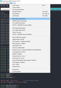

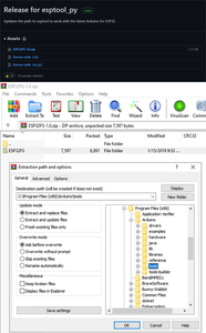

Step 6: Install ESP32 Filesystem Uploader
The primary purpose of the ESP32 Filesystem Uploader is to let you upload files into ESP's filesystem. In this tutorial, the purpose of this tool is to upload an empty SPIFFS image into ESP.
Download the file called ESP32FS-1.0.zip from https://github.com/me-no-dev/arduino-esp32fs-plugin/releases/
And then extract the content of the archive into the "...\Arduino\Tools\" folder.
After that, restart the Arduino IDE.
Step 7: Switch the Partition Scheme to the "Huge APP (3MB No OTA/1MB SPIFFS)"
You have to switch the partition scheme to the "Huge APP (3MB No OTA/1MB SPIFFS)" before you continue working with ESP32 because the firmware for the vault is too big for the default partition.

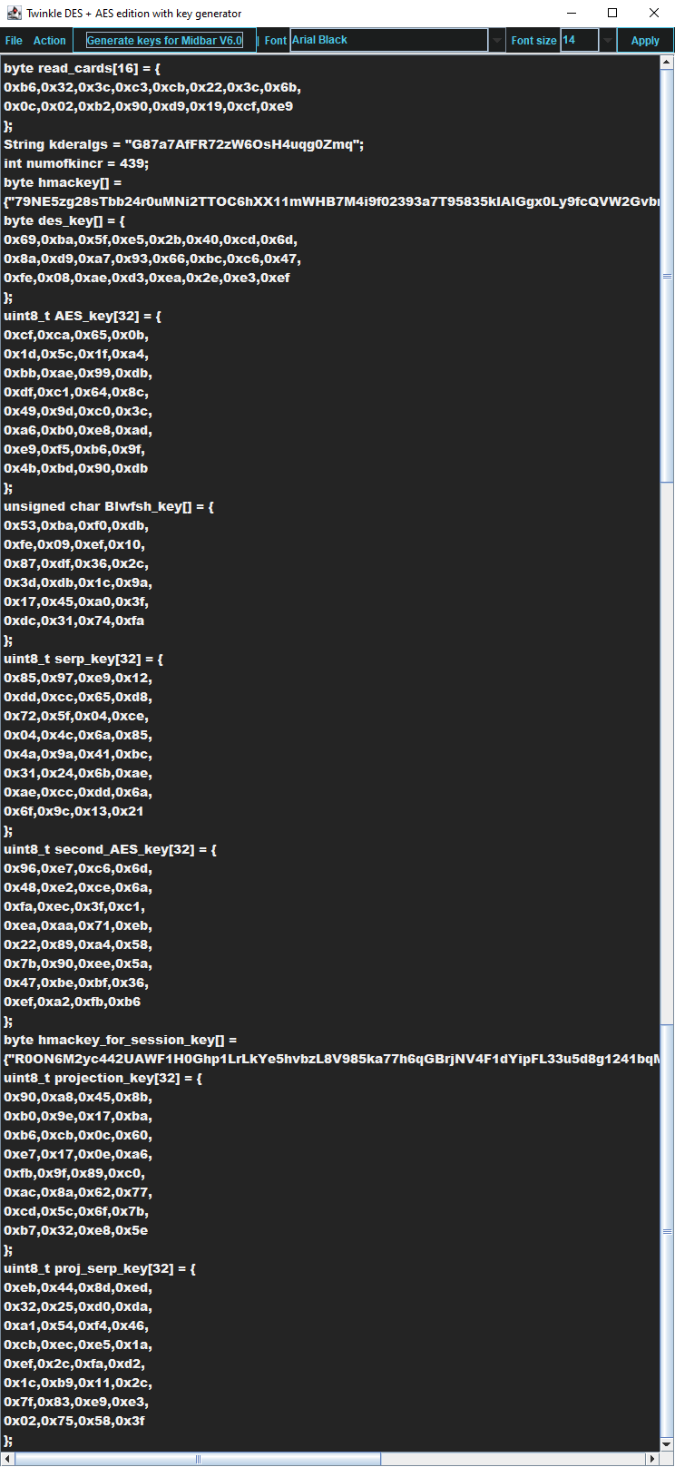

Step 9: Generate Keys
To make the unauthorized deciphering of your data computationally infeasible - It is crucial to generate your own keys and never reuse them
It's entirely up to you how to generate the keys. I can only offer you an option to do so.
I've modified one of my previous projects to work as a random number generator, the generated output seems "random enough" for me, but I haven't run any tests. So, I can't guarantee that it's random.
Use it at your own risk!
To generate the keys - launch gen.exe from the "ESP32_Version\V6.0\Untested RNG" folder and click the "Generate keys for Midbar V6.0" button. The background turns from dark gray to light gray when you press that button.

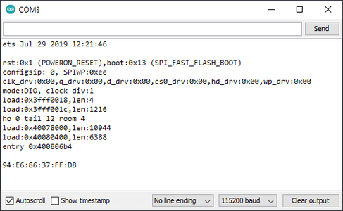

Step 10: Get the Receiver's MAC Address
To get the receiver's MAC address, upload this code into the receiver board.
#include <WiFi.h>
void setup(){
Serial.begin(115200);
Serial.println();
Serial.println(WiFi.macAddress());
void loop(){
Then open the Serial Terminal, and reboot the board.
If done correctly, you should see the MAC address in the console.
The MAC address of this board is 94:E6:86:37:FF:D8

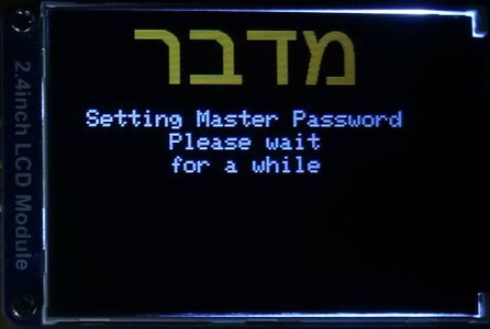

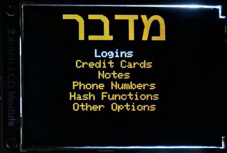

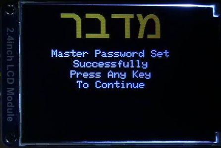

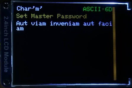

Step 17: Set Master Password
To use the Midbar, you first need to set the master password.
You can't change your master password without performing the factory reset first!
Midbar won't be able to decrypt your data without your master password because the keys for the encryption algorithms are partially derived from it. Perhaps it won't even unlock without the correct master password.
When you're done entering your master password, press either the "Enter" or the "ESC" key on the PS/2 keyboard.

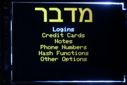

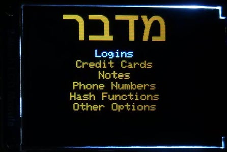

After you've unlocked the vault and got to the main menu:
  • Press the "" (DOWNWARDS ARROW) key on the PS/2 keyboard to go down the menu.
  • Press the "" (UPWARDS ARROW) key on the PS/2 keyboard to go up the menu.
  • Press either the "Enter" key on the PS/2 keyboard to open the selected menu.
  • While in the submenu, press either the "Esc" or the "Backspace" key on the PS/2 keyboard to return to the main menu.

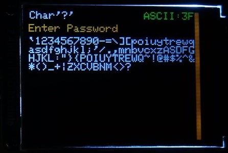

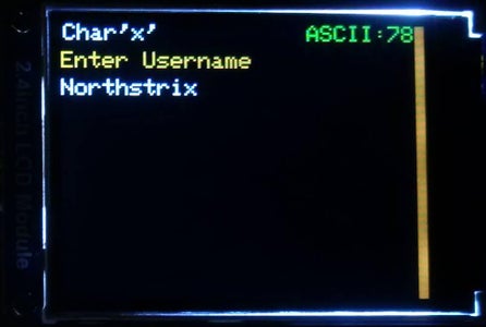

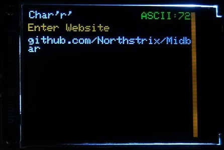

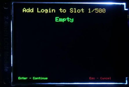

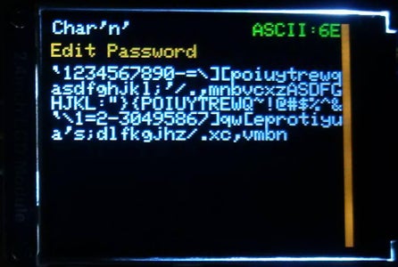

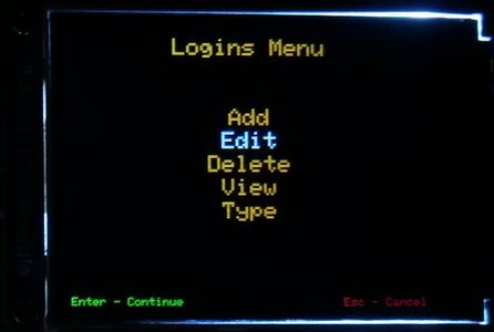

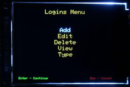

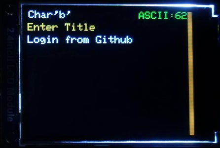

Step 18: Add Login
Midbar V6.0, just like several other versions that came before it, utilizes the 3DES + AES + Blowfish + Serpent encryption algorithm in CBC mode with an integrity verification feature to encrypt your data. Encrypted data is stored in the ESP32's built-in flash memory.
To add a login:
  1. Select the "Logins" line in the main menu;
  2. Press the "Enter" key on the PS/2 keyboard;
  3. Select the "Add" line;
  4. Press the "Enter" key on the PS/2 keyboard;
  5. Choose the slot you want to put the login to by pressing the "←" (Leftwards Arrow) and "→" (Rightwards Arrow) keys on the PS/2 keyboard;
  6. Press the "Enter" key on the PS/2 keyboard;
  7. Enter the title;
  8. Press "Enter" on the PS/2 keyboard;
  9. Enter the username;
  10. Press "Enter" on the PS/2 keyboard;
  11. Enter the password;
  12. Press "Enter" on the PS/2 keyboard;
  13. Enter the website;
  14. Press "Enter" on the PS/2 keyboard.

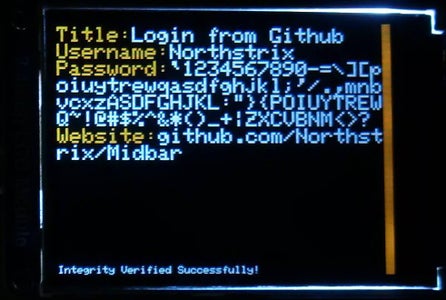

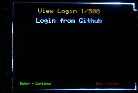

Step 19: View Login
To view a login:
  3. Select the "View" line;
  5. Choose the slot from which you want to view the login by pressing the "←" (Leftwards Arrow) and "→" (Rightwards Arrow) keys on the PS/2 keyboard;
  6. Press the "Enter" key on the PS/2 keyboard.
*All credentials demonstrated here are entirely fictitious. Any similarity to actual credentials is purely coincidental.

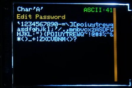

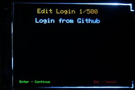

Step 20: Edit Login
To edit a login:
  3. Select the "Edit" line;
  5. Select the login you would like to edit by pressing the "←" (Leftwards Arrow) and "→" (Rightwards Arrow) keys on the PS/2 keyboard;
  7. Enter the new password;
  8. Press "Enter" on the PS/2 keyboard.

Step 22: Delete Login
To delete a login:
  1. Select the "Logins" line;
  3. Select the "Delete" line;
  5. Select the login you would like to delete either by pressing the "←" (Leftwards Arrow) and "→" (Rightwards Arrow) keys on the PS/2 keyboard;
The process of working with records of other types is very similar to the process of working with logins.

To send the password to the receiver:
  • Select the "Other Options" line in the main menu;
  • Press the "Enter" key on the PS/2 keyboard;
  • Select the "Send Password" line;
